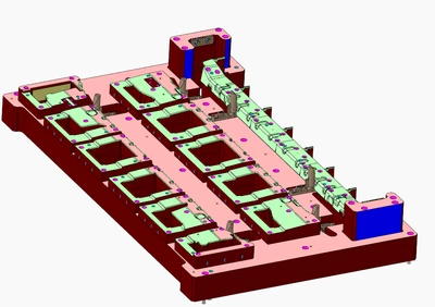

I've an assembly with a lot of parts assembled in a plate.
Now I need to transfer the holes from the assembled parts, to the main plate. I need to mantain them parametrized according the dimension of the hole of each part, and the same time the amount of the holes of each part (pattern by reference).
Doing this hole by hole, or even part by part, is really painfull...
I've tested IFX, and I think isn't that versatible, because when we add or remove screws, we need to do a lot a things to update.
My question is, what methods do you use to make this task?
