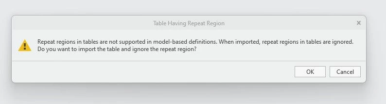

Hello Vnamboodher,
1.. I referred the help documentation but I couldn't able to identify BOM in MBD related topic,
2. I tried to place Predefined BOM from the TABLE option, Error message popped that we can't place Repeat region table in the MBD area.Repeat region error.jpg
3. Its My customer request to show the balloons with BOM. for welding structure.
Please let me know if you find any other way to add BOM and balloons(parametric) in the MBD.
Regards
February 28, 2025
MBD functionality does not enable to generate BOM table. You have to create a drawing and put repeat region table into it.
