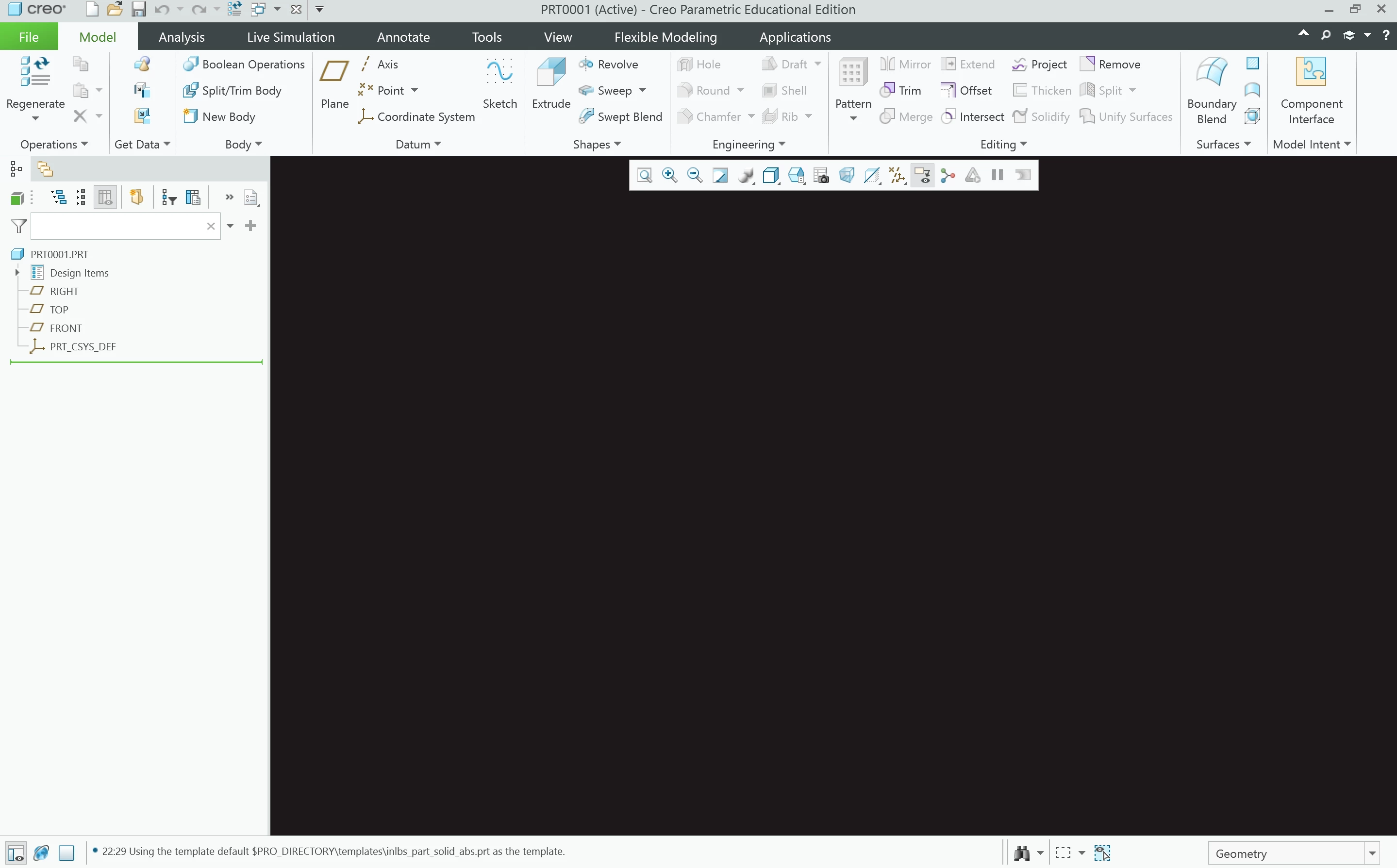

after installation of creo 11 student version the screen became black and no entities are highlited when drawn. My graphic card is RTX3050. windows 11

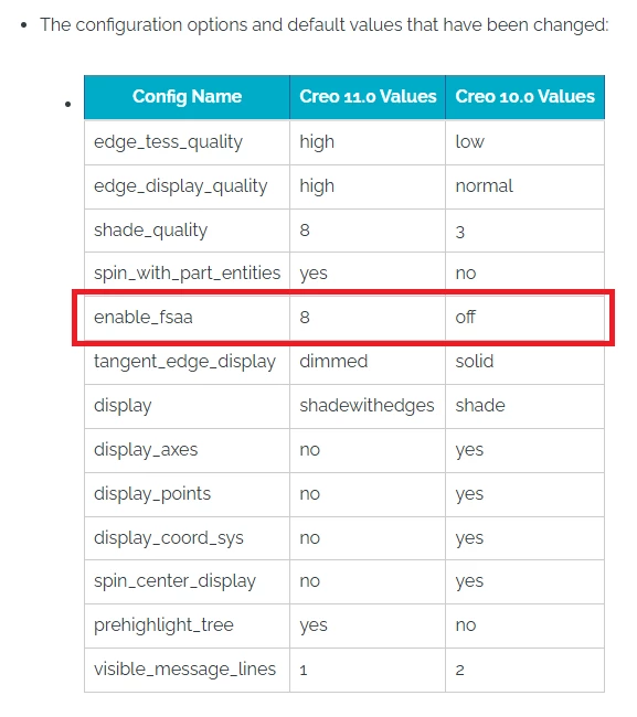

This is likely due to the change in the default value for config.pro option enable_fsaa.  Setting this to a different value in session and causing a screen repaint should resolve the black screen.  You may need to try a few different values for the option to find which works for your configuration.
Refer to CS348177 for more information.
