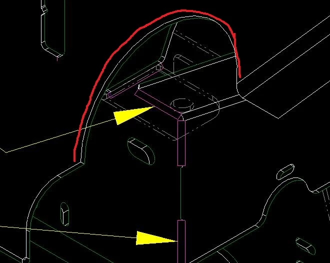

    I had one user that indicated this might be possible by making the section
    as a simplified rep at the PART level, as opposed to doing the family
    table. I could not get this to work, and that user said that he has a
    document that he'll forward to me that explains how to do that.
    But, in the meantime, I finally DID figure this out, on my own, but it
    took me a while. And when I got it all done, it didn't work for me
    anyways, because the assembly that I wanted to do this on happens to be a
    welded assembly, and the welds under the cross section "area" are all
    displayed, and there doesn't appear to be away to make them go away with
    hidden view modes. In order to get rid of them, I would need to put them
    on a layer specific to that view, and then hide them. I could do that,
    and get it to work for me.
    But, these are the steps that I had to go thru to get this to work:
    Go to the view in the drawing
    Create a NEW cross section in that view
    I chose OFFSET, because I wanted to control the "shape" of the cutout
    (NOTE: the OFFSET section REQUIRES that the end lines be straight, so
    your sketch will need at least two straight lines)
    I chose BOTH SIDES, but I don't know that it makes a difference
    Enter a name
    Sketch the "cut" that you want ON the part that you want to cut
    Choose refs
    Create sketch (with at least end lines straight), and end sketcher
    September 15, 2011

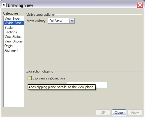

    Have you tried to offset a plane just behind the plane for the cross section, and clip the view in the Z direction
    September 15, 2011
    I did try this, but it basically wiped out most of my view.
    September 15, 2011
    I now more than sent this out, and Charlie provided me with the document
    that explains how to do this with Simp Reps, at the part and assembly
    level.
    THIS IS THE WAY TO DO THIS! Much easier, and really what I wanted anyway.
    There is no way that I would have ever figured this out on my own.
    Thanks again Charlie!!!
