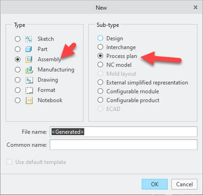

I haven't used it in years but there is another option. Process plan for assemblies.
It allows you to create process steps without affecting the original model(s).
A quick search I found this document http://www.datajett.com/Cadd/ProE/Tuts/HawkEye/Proprocess.pdf (from 2000)...
Dec 7, 2022 9:24 AM UTC
This sounds promising. Let me give it a try. But in the meantime, I have used layers: added components into different layers and used them in combined states and used them on the drawings. It seems to be working for my purpose now.
