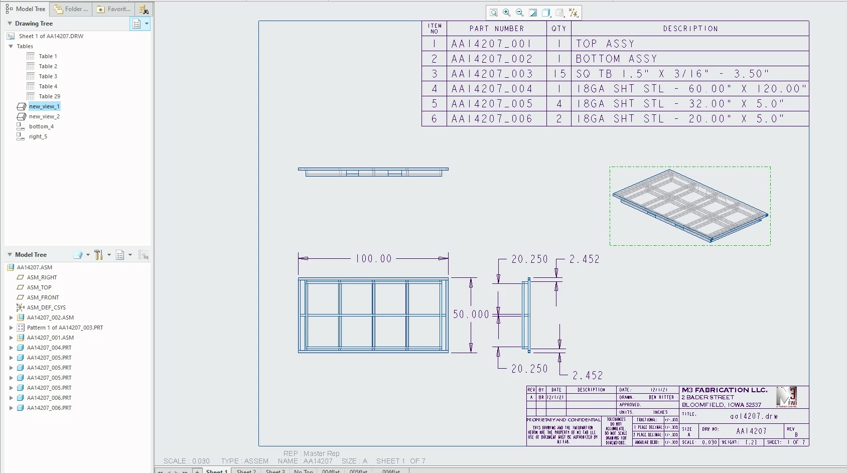

    Dec 1, 2021 9:44 PM UTC
    Good thought. I checked the tree and don't see anything hidden our out of line. See attached snapshot.

    Dec 1, 2021 9:46 PM UTC
    Change to the annottation tab and expand the views to see hidden balloons, if they are there.
