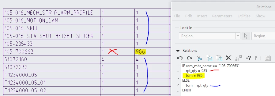

When I'm adding relations to repeat region they don't work.
For example I added:
   if ASM_MBR_TYPE=="Bulk item"
     QTY=5
   else
     QTY=rpt_qty
   endif
and the qty of bulk items is not changed.

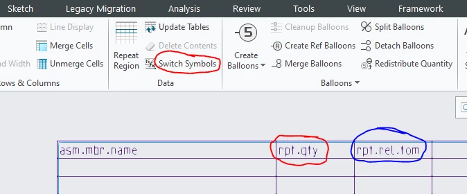

I'm not sure you can change the 'rpt_qty' value directly, I think you have to use your own parameter, like 'qty'.  For this to display correctly, you have to call this parameter out in place of rpt.qty in the table.  For example:

Still my relations don't work at all. I don't know how, because I have properties in repeat region ->relations->local parameters, and when I add other table with type (part/bulk/assembly) it's shows proper type. I don't know where is the problem.

October 28, 2020
Can you either share your drawing and models or take screenshots of the repeat region relations and the repeat region table cell parameters?
