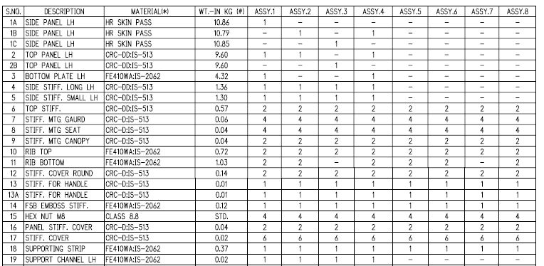

I want to create a BOM from assy, which would contain a family table of it. Each innstance of assembly has different components. Is that possible in Creo to create a BOM table which would show all instances of the generic assembly with the same indexes and (different) quantities?
For example
      Assy1 Assy2 Assy4
INDEX QTY COMPONENT DESCRIPTION COMPONENT NAME
1 1 Bracket BRACKET1 BRACKET2 BRACKET3
2 6 Plate PLATE1 NO PLATE2
3 3 Angle ANGLE1 ANGLE1 ANGLE6
We have a lot of such drawings in AutoCad. Assemblies are big and it is monkey work to fill them manually.

i have same problem
i have to learn how to make bom table for assemblies containing same parts
