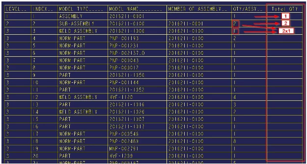

Hallo 🙂
Could you tell me, please, how I can get the Member of assembly  to the BOM? Like in the BOM from gpeetersem on the picture.
What is the report symbol? Attributes are No Dup/Level and Recursive?
And is it possible to get to the BOM the file path of the part or subassembly?
Thank you in advance

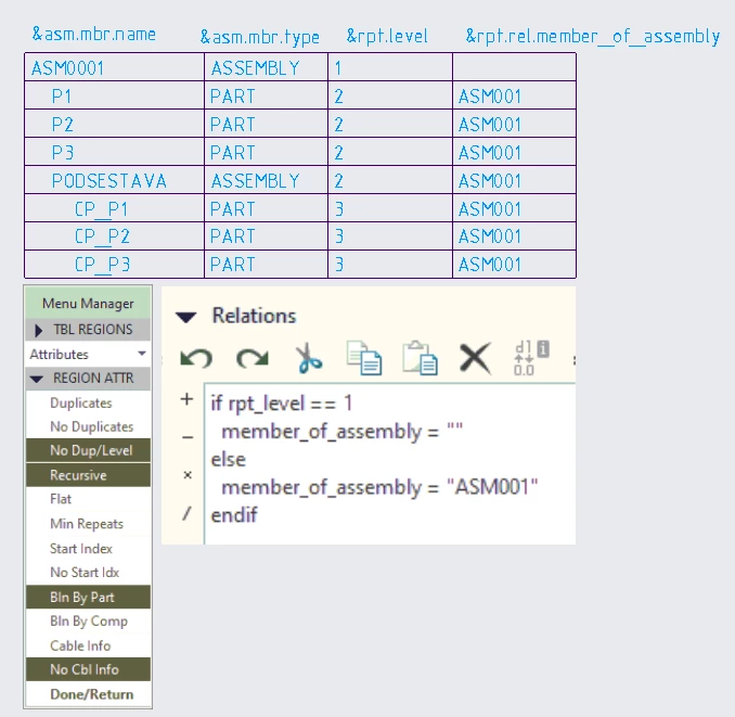

maybe you can use this "solution":

Thank you for your help.
But in your example should be this value for CP_P1, CP2, CP3 "PODSESTAVA", not "ASM001", because the level is 3. My idea is to fill it automatically, not to write "ASM001, ....." to the relations :-(.
Do you have another idea, please? Maybe, I explained my query incorrect.

requested repeat region functionality is not implemented. You cannot show name of component parent assembly using some "special" parameter.
The only solution is to create member_of_assembly parameter in every model and display it in repeat region using asm.mbr.member_of_assembly parameter. I case that creation of model parameters is not suitable, you can create component parameter named member_of_assembly and display it using asm.mbr.cparam.member_of_assembly parameter.
