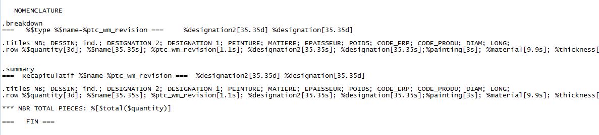

I have a custom nomenclature to define certain parameters that need to appear in my BOM.
For Example: Designation 1, Designation2 , Material, Pipe diameter, Pipe length etc....

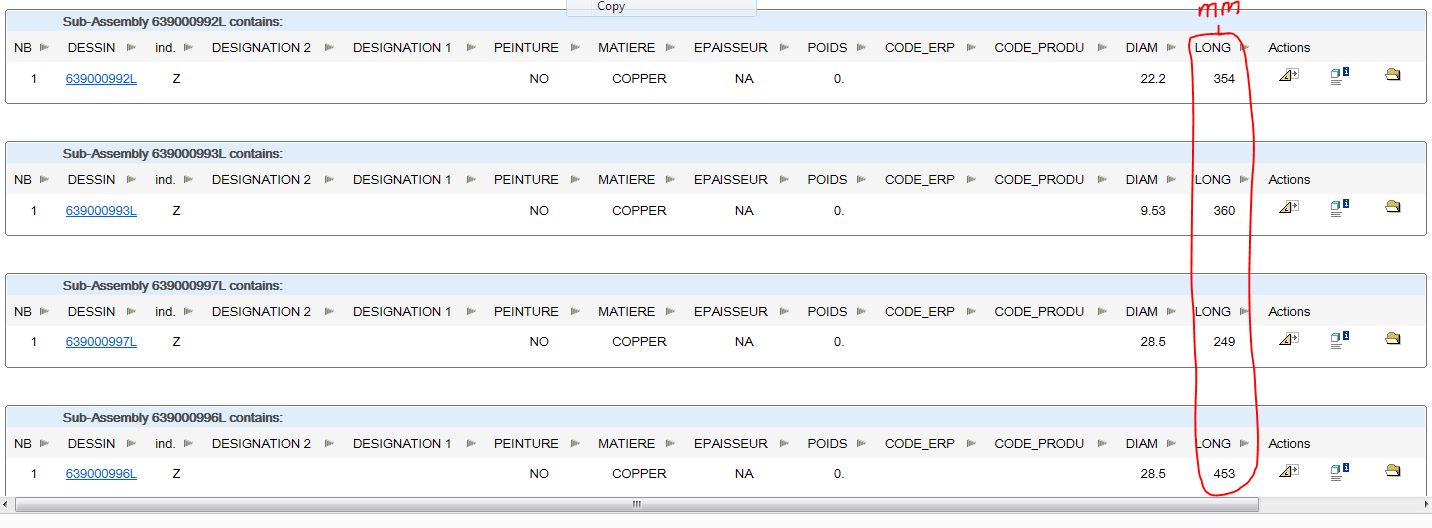

I create my Model in mmNs unit, so normally when I get these details I have all the values in mm, but I need the Pipe length parameter in Meters.
Can you suggest what can be done to get this?
Note:
The assembly has 200+ components and I cannot add "relations" or "parameters" in all parts for the moment.
Attached my sample Nomenclature file.
