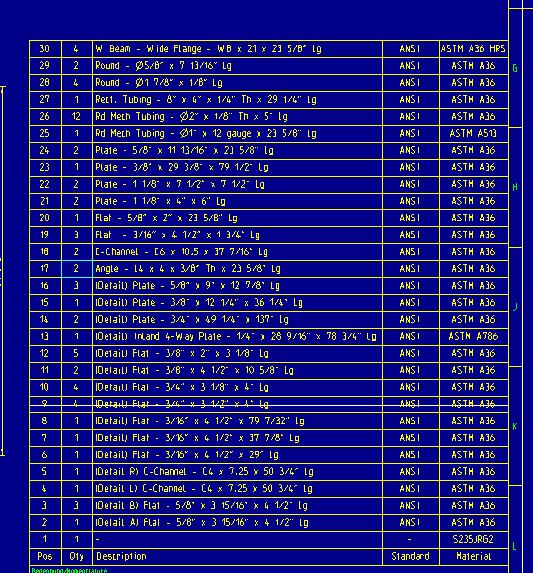

In the BOM below, there are 30 positions being shown. I only have 29 parts in my model tree and can't seem to find where position #1 is coming from. Any ideas?
December 19, 2014
Ok, I figured out that the Skeleton was being shown with a material. So, I updated the Repeat Region by Excluding the Skeleton from the BOM.

Do you know what a S235JRG2 is? Since that shows up in the BOM, that would be a starting point.
fgallagher1-VisitorAuthorAnswer
December 19, 2014
