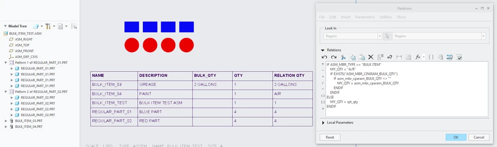

While there are some 'hacks' to get at parameter values in the top level assembly from a repeat region, they won't be processed on the same row in the table.  Each row in a repeat region is only looking at one thing at a time.  If the row is displaying data from a component, then it won't also display information from the top level assembly in that same row.
Since you are looking to override the qty. or "A/R" on a row by row basis, it probably makes sense to use component level parameters.  These can be created, and set (and even calculated if you want) at the assembly level without any impact on the bulk item.  Your repeat region relations can then check for this component level parameter and use its value instead when present.
In the example below, BULK_QTY is a component level parameter and it only exits on BULK_ITEM_03 in the context of the assembly.
Sample data is attached.  Files were created in Creo Parametric 6.0 and cannot be opened in earlier versions.
