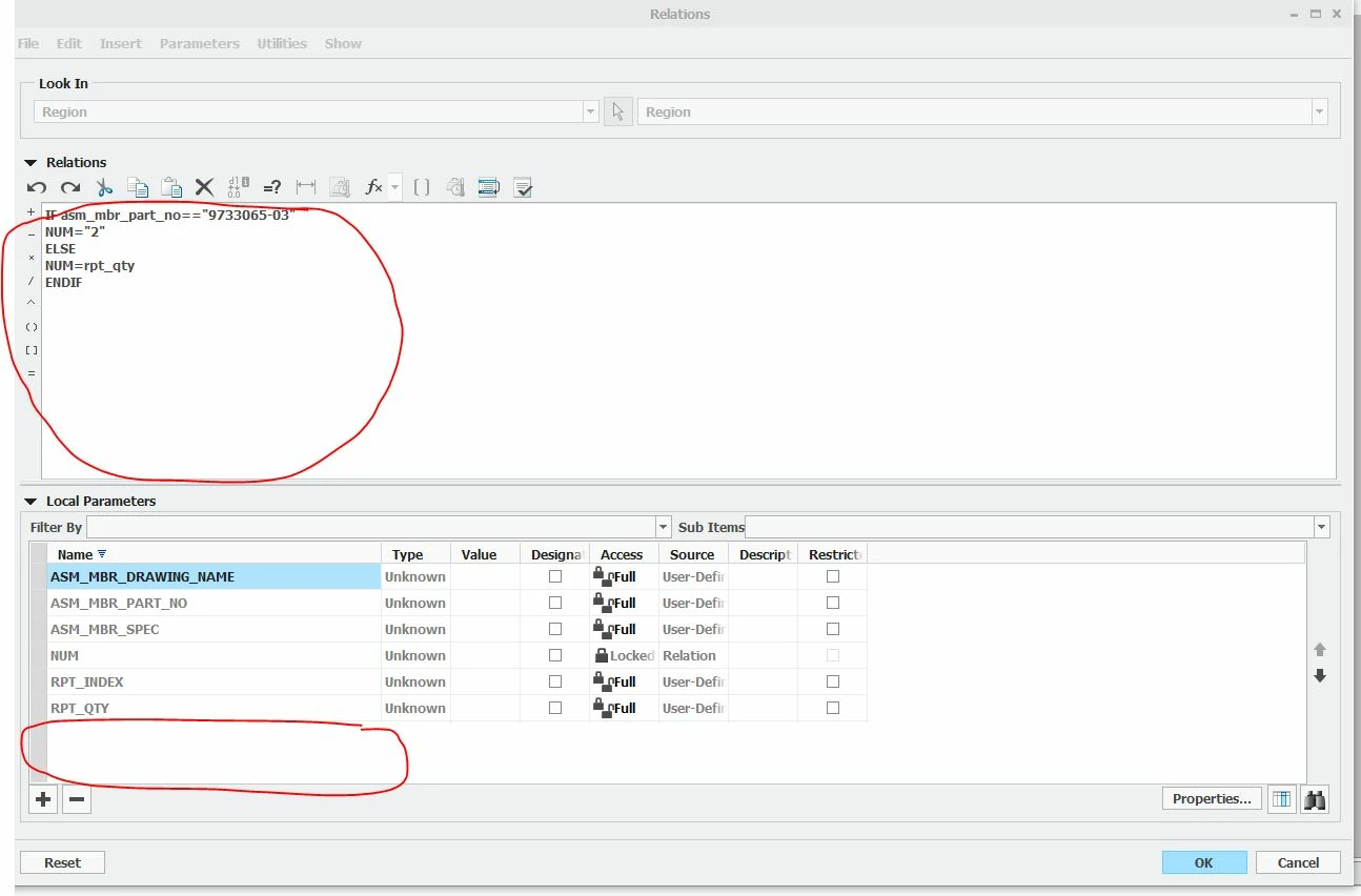

hey All,
is there anyway to add "new" local parameters and "new" relations to existing dwg bom repeat region with a mapkey?
trying to create mapkey do accomplish this but it does not work
tried loading a "new configuration" xml file with no luck either

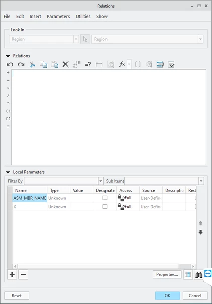

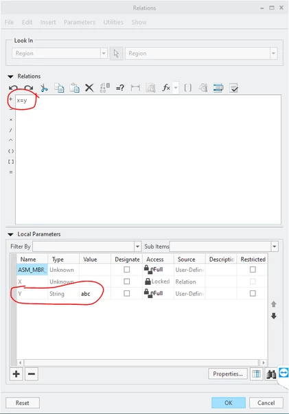

Relations dialog box contains File > Import command, therefore you can load relations from text file.
Modified x3 mapkey loads relations from my_relations.txt file. See uploaded config.pro file.

why you need mapkey ? Do you plan to do repeat region modification every day ? If I were you I would save relations into txt-file and Copy/Paste them from Notepad to Creo.

in Creo  7.0 the mapkey saved in attached config.pro works well.
Repeat region before modification
Repeat region after modification using mapkey x3 ... see video
