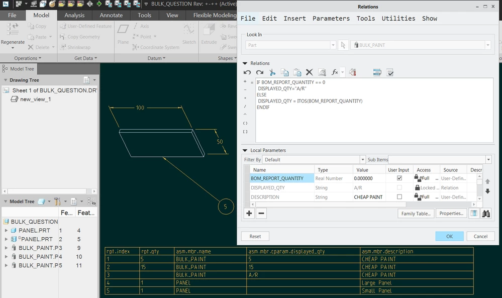

Probably many ways to hack this; I believe you are doing this on the repeat region side, but also consider that your bulk item itself can have relations that modify its parameters.  If, by convention, you display these (component) parameters on your drawing tables, it might simplify things...  not sure.
The method below does not require repeat region relations:
Suppose you set your bulk item to have a STRING parameter called "DISPLAYED_QTY"
Then you can display this parameter in your repeat region table by having a column &asm.mbr.cparam.DISPLAYED_QTY
Inside your bulk item, define a relation that's something like:
IF BOM_REPORT_QUANTITY == 0
 DISPLAYED_QTY="A/R"
ELSE
 DISPLAYED_QTY = ITOS(BOM_REPORT_QUANTITY)
ENDIF
So if user enters "0" for BOM_REPORT_QUANTITY when assembling the bulk item, then that component's DISPLAYED_QTY parameter will be set to "A/R"...
Note: I do not really understand how this all works behind the scenes.  Each instance of the bulk item is unique in that it is a separate feature in the assembly tree, but yet they all have the same session ID...  The bulk item relations exist inside the bulk part, but they seem to be evaluated in the assembly context for each component instance and they affect component parameters.  Along the same lines, the bulk item components seem to automatically "inherit" their source bulk part parameters (as component parameters).

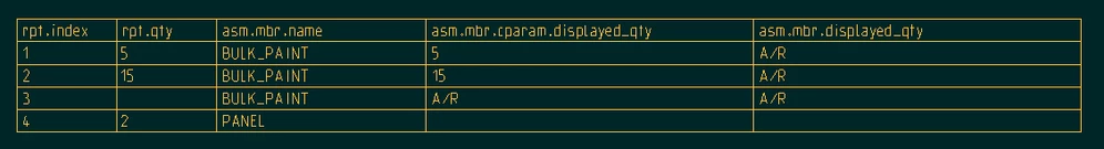

Note how calling out &asm.mbr.displayed_qty in the repeat region does not work:
(because in the source bulk part, the DISPLAYED_QTY parameter will always be evaluated to "A/R")
Anyway, not sure if I helped, but wish you good luck!  Please keep community posted about how you got the units of measure reporting to work.
