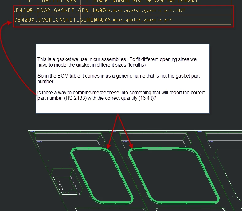

Gurus,
Was wondering if anyone has come up with a solution to this?
[cid:image002.png@01CD4EFC.DF312F00]

On 06/20/12 15:53, Andy Hermanson wrote:
> Gurus,
Flexible components.
Introduced somewhere in the 2001 or Wildfire 1 timeframe.

Jun 20, 2012 10:47 PM UTC
Are flexible components only accessible using the flex 3C license that cost
an arm and a leg? Ah soo tempting to find out... I think so. I think that
is why we never used it.

Jun 21, 2012 12:00 PM UTC
Flexibility is available with the base license (foundation).
Tom U.
Jun 21, 2012 12:38 PM UTC
Here's my 2 cents....
If you're modeling the gasket at different lengths, you have a family
table for all of these gaskets?
Use or create a parameter for the part number of this gasket to be used
in the BOM and add to the family table.
I have had this type of parameter update automatically by parsing the
length of the gasket value onto a parameter that includes the generic
part number as well.
The length of the gasket can be found by creating a saved measurement of
the curve length for the 'spine' that the gasket is swept along.
It may report the length in inches, so you have to do more programming
kung-fu to get the value in decimal feet and then convert this to a text
string that can be appended to text string that includes the generic
part number.

Jun 21, 2012 4:43 PM UTC
Flexibility is in Foundation. Right click on an assembly component and pick "Make Flexible".
