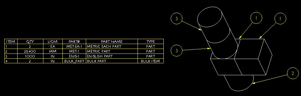

So, just when I think I was all done setting up the my new BOM TABLE so that I could use FLEXIBLE parts and use the LENGTH (or similar) as the qty for said component in the BOM REPEAT REGION...I run into an issue with the BOMQTY of the "FLEXIBLE" components not totaling
Components/Models:
MET-EA-1 is a "RIGID" part, that has BOMUOM="EA" and does not contain the BOMQTY parameter
MET-1 is a FLEXIBLE solid model BOMUOM="MM" and BOMQTY=d0 (length) through a RELATION, currently d0=25.4 (mm)
ENG-1 is a FLEXIBLE solid model BOMUOM="IN" and BOMQTY=d0 (length) through RELATION, currently d0=1 (in)
BULK_PART is a bulk item model, BOMUOM="IN" and does notcontain the BOMQTY parameter. As all "BULK" items in Pro/E, it contains a parameter called BOM_REPORT_QUANTITY,which is set for USER INPUT
Assembly:
The assembly has the following components and quantities...
MET-EA-1: two models assembled, therefore Qty=2 EA
MET-1: one model assembled, the length of the model is 25.4 mm, therefore Qty=25.4 MM total.
ENG-1: two models assembled, the length of each model is 1 in, therefore the Qty=2 IN total (at least it should be!)
BULK_item: this bulk item was added to the assembly twice, with the user input for the BOM_REPORT_QTY set to 1 (IN) each time, therefore the Qty=2 IN total. I did this on purpose because I wanted multiple instances.
Notice below all of the quantities total up correctly except for the ENG-1 part. The BOMQTY is not totaling correctly. The Qty should be 2 IN since there are 2 instances, each at 1 IN length.
FIGURE 1

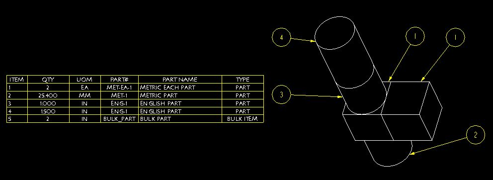

Below is what happens when I take one of the ENG-1 parts and make it flexible, and change the length to 1.5 IN.
The total qty for the ENG-1 part should be 1 IN + 1.5 IN = 2.5 IN. The items are not totaled. They are instead listed separately.
I do have No Duplicates/Level set for the REGION.
FIGURE 2
So it looks like "BULK ITEMS" and "RIGID" components total up just fine,even if you have assemble multiple times (instances).
However, for the "FLEXIBLE" components if the length is the same for multiple instances, then it treats the two instances as "the same" or "a duplicate" and lists one row, however the QTY is not "totaled".
If the instances are of different lengths then it treats them as "not the same" or "not a duplicate" and lists them separately, as above.

So after several discussion with PTC Technical Support it appears that there is a know issue with REPEAT REGIONS and the way FLEXIBLE MODELS are treated or at least the way they are or are not recogonized as unique (or not).
I was referred to SPR# 1353474. However, this SPR is not "customer viewable". Also, I am not clear as to wheter PTC will simply add my information to the existing SPR or create a new one. If they create a new one or send me a link to access the existing one, I will post an update.
The issue:
Even though the FLEXIBLE ITEMS are identical execpt for the "varied item(s)", the REPEAT REGION treats them as seperate models.
This is why the 1.500" long (2X) and 1.000" long (1X) ENG-1 PARTS show up on two different lines since the lengths are different.
This is also why the 25.4mm long (2x) MET-1 PARTS show up on one line since the lengths are the same.
The Work-Around:
  • Live with the FLEXIBLE items showing up on seperate lines if they are different lengths
  • The "adding" or "totaling" has been fixed by editing the equation to calculate the BOMQTY see below
IF EXISTS ("ASM_MBR_BOMQTY")
BOMQTY=asm_mbr_bomqty*rpt_qty
ELSE
BOMQTY=rpt_qty
ENDIF
As you can see below, the table is correct with respect to Total Qty, but may have the same partnubmer on multiple lines (one line per discrete length).
I have attached the updated files.
