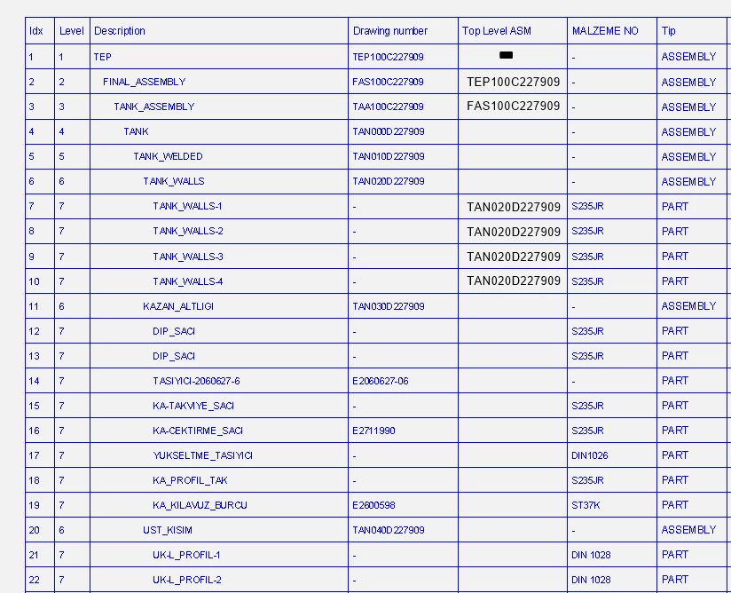

BOM Table with top level assembly name
I have a BOM table exploded the all sub-components. I can reach all component's name and parameters. However I couldn't reach top level information.
Is there any way to add name or its parameter of top level assembly?
Please see the attached picture for the sample.
Thanks in advance!

I know I'm digging out an old topic but it turned out I'll need something similar to this for the ERP system we're implementing, so I was wondering if someone found out how to solve this problem. I need the file name of the assembly that the part/sub-assembly belongs to. &asm.name only gives the file name of the top level assembly which doesn't help.

I think requested functionality is not available. You have to get information manually, for example:
  • open assembly
  • use Bill of Materials command (writes .bom.* file into working directory)
  • extract information from .bom.* file
