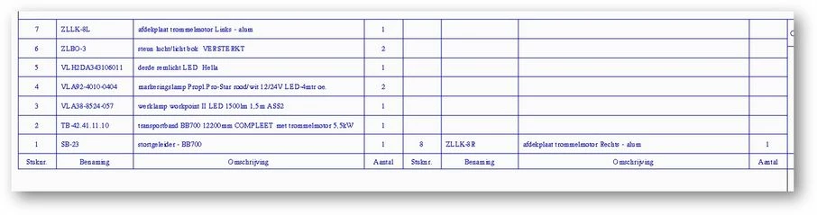

Is it posible to create a Bom table like below?
with repeat region?
so its start filling left bellow corner. when it reaches the 7th row.
then it jumps over to the second collum.
Creo 9
kdirth
March 11, 2026
I don't believe that is possible.  You will need to use Paginate for each split.
