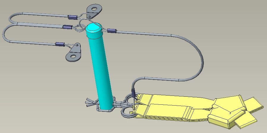

Seems I used to know how to do this, but...  Basically I have an assembly with subassembly that is used in two different locations.  Think of a quick release pin with a cable lanyard on it.  The pin and cable hook on in different configurations for the two different locations.  I have created a family table in the subassembly to create the two configurations.  Assembled those into my assembly and created a drawing of the assembly.  When I add my BOM Table to the drawing, it shows the two instances separately.  What I want is for it to show a single line, quantity two, of the pin and cable top generic assembly.  I have tried using the asm.mbr.top_generic bit, but that STILL shows the subassembly on two lines of the BOM.  What am I missing???

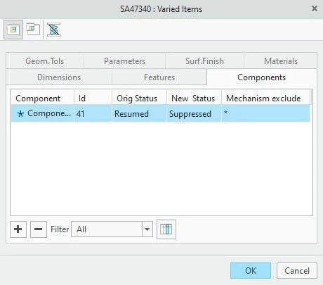

You can have suppressed components in the generic model and use flexibility to turn them on.

Maybe... though, it's a bit more complicated than that.  I have more than one part that is in a different location, so while I could use flexibility to deal with the cable, it wouldn't work with the other parts...  Attached is a picture of my generic.

Install the generic in your model and use the Components tab of flexibility to turn off those parts not needed.
To take it a step further, apply a predetermined flexibility to the subassembly.
  • File / Prepare / Model Properties / Tools - Flexible - change
  • Add all components you may want to flex off.
You will then be asked if you want to use the predefine flexability when you first add it to your assembly.
