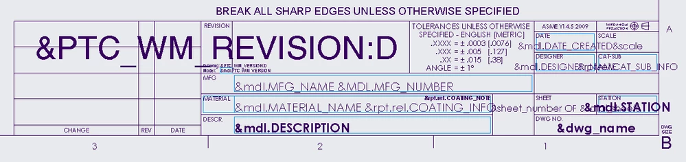

Actually, repeat regions work fine in part drawings, it's just that the information that can be displayed is entirely different.  I use them all the time to refer to individual model parameters, but they can also be used for family table instances, inseparable assemblies, and I think even multi-body.
This title block from our part-level format has eight separate repeat regions:
