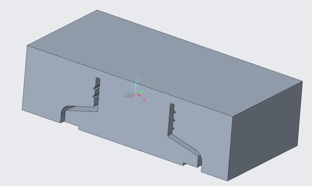

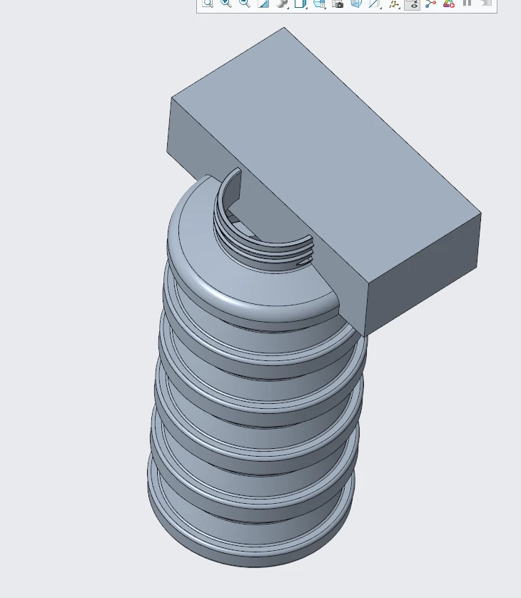

Hey,
I want to make a mould cavity from the bottle
But when I perform the boolean operation I’m not getting a complete cavity,
This below picture shows also bottle that I’m trying to make
How to get a cavity on the extruded block?

Create a Fill surface to “seal” the top of the bottle then Solidify the surface.

Can you “fill” the bottle such that it has geometry to remove the material from the inside of the bottle?

Yes I filled and solidified
It worked
