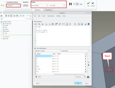

Hello everyone,
I’m trying to insert a brachistochrone curve into a 3D model in Creo Parametric 10 on the XY-plane using the “Curve from Equation” feature. Unfortunately, I can’t seem to get it to work… The only result I get is a short straight line segment.
The formula for the brachistochrone curve should be:
R = 4.8 (own shoosen radius)
X = R * ( T - sin(T) )
Y = R * ( cos(T) - 1 )
Tmax = 3.142 (= Pi)
Can someone help me with this?
This is what my result is:
VoronovAnswer
Dec 9, 2025 11:04 AM UTC
Hi! Try this
Tmax = 1
X = R*(T*pi*2-sin(T*360))
Y = R*(cos(T*360)-1)
Dec 9, 2025 9:20 AM UTC
in Creo, the trigonometric functions use degrees, not radians.
6-Contributor
Dec 9, 2025 9:52 AM UTC
Thanks for your quick reply Pausob!
OK, that's good to know, but what should the equation be then?
Dec 11, 2025 12:11 AM UTC
you can leave the equation as is, just increase the range from 0 to 360.
Voronov12-AmethystAnswer
Hi! Try this
Tmax = 1
6-Contributor
Dec 9, 2025 1:50 PM UTC
Thanks Vronov, this works!
