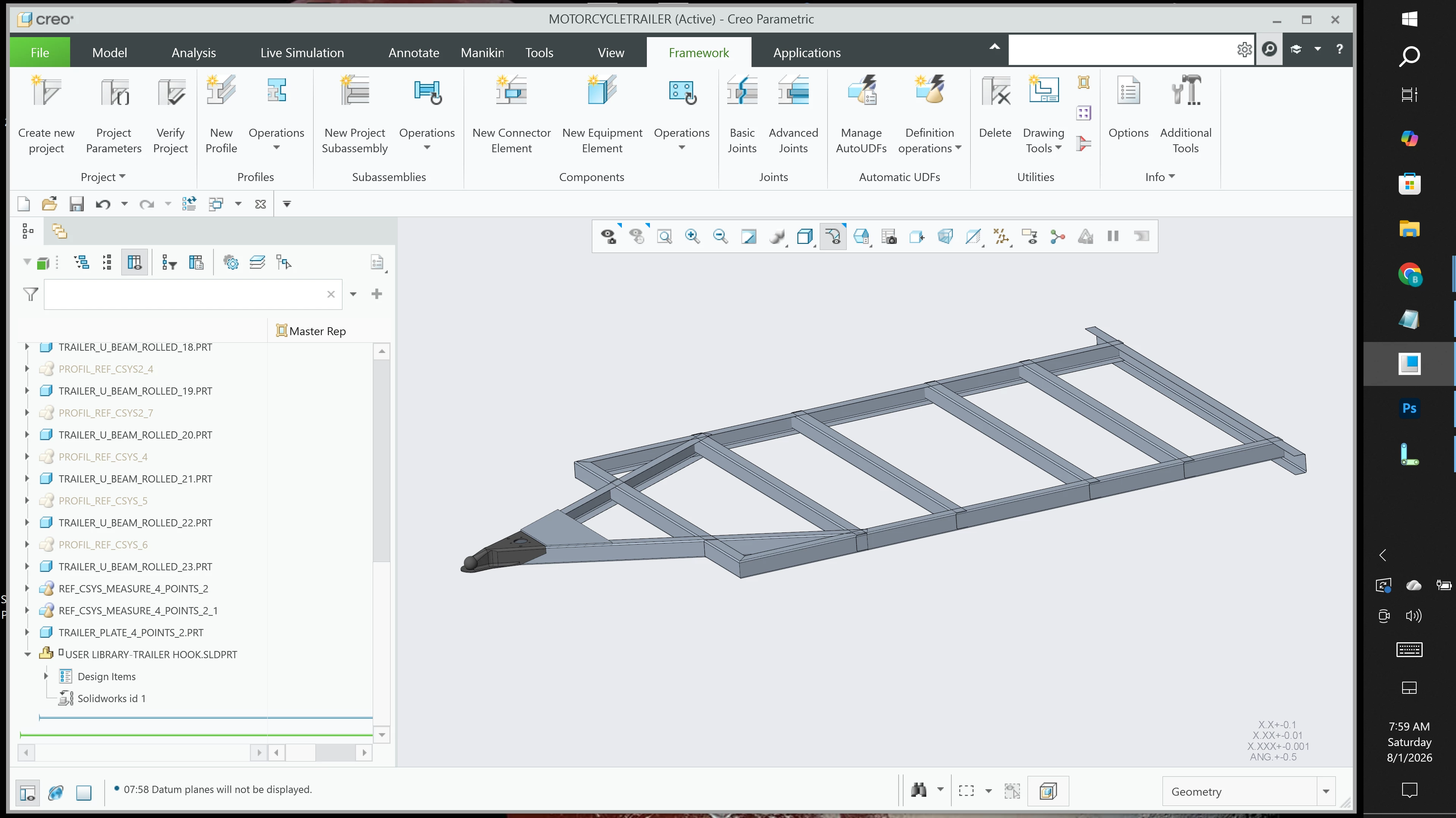

bbrejcha
Aug 1, 2026 12:02 PM UTC

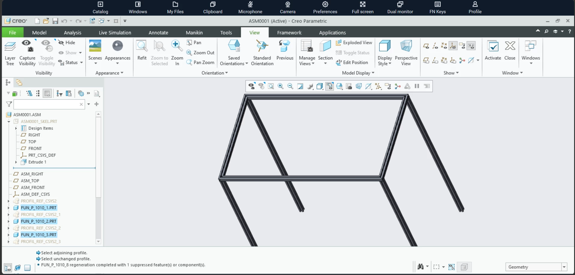

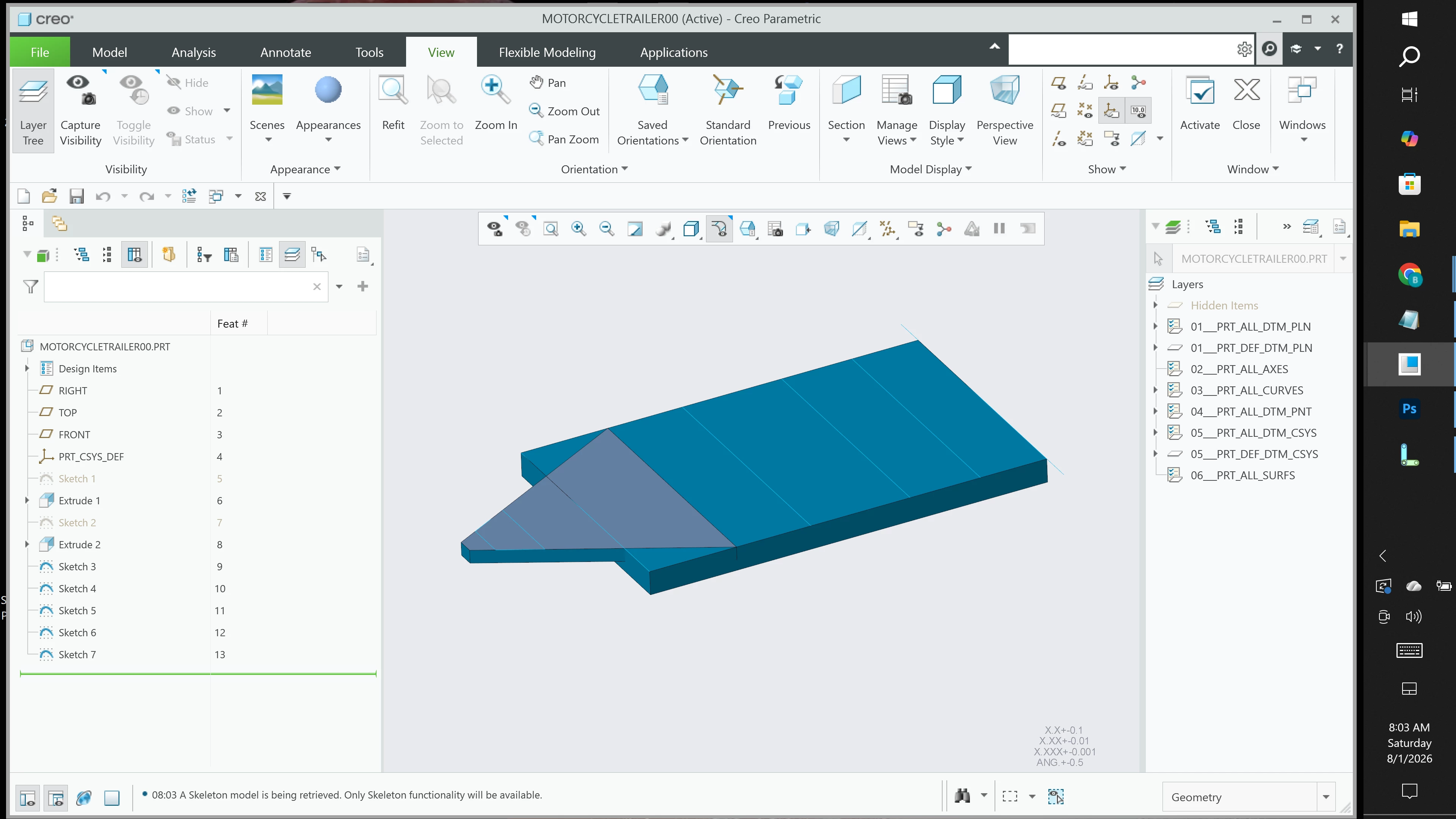

Michael,
Im working on the motorcycle trailer.  Used a skeleton file w/ two separate bodies.  One to drive the A frame + antoher for the base platform.  I used modify profile size and move profile effectively.   I struggle some as i want to rebuild the assembly using traditioanl assembly constraints as you might notice from the screen grab.
the skeleton
Bart Brejecha designengine.com
Michael_Bourque
Aug 1, 2026 12:53 PM UTC
In general, no. PTC Advanced Framework Extension (AFX) is fundamentally coordinate-system driven, not constraint-driven.
AFX places structural members, plates, and connection components using:
  • Reference coordinate systems
  • Placement points
  • Section orientation
  • AFX-generated placement logic
These components are typically assembled with fixed placements derived from the AFX framework rather than using standard Creo assembly constraints (Mate, Align, Insert, Tangent, etc.).
That said, there are a few nuances:
  • During AFX creation: You cannot tell AFX to build its framework using traditional assembly constraints instead of its coordinate-based placement.
  • After creation: You can manually redefine an AFX component using standard Creo assembly constraints, but this generally breaks the intended AFX workflow.
  • Non-AFX components: You can freely assemble ordinary Creo components into an AFX assembly using normal assembly constraints.
So if your goal is to have an AFX assembly regenerate based on mating faces and assembly constraints like a conventional Creo assembly, AFX does not support that workflow. It is designed around parametric reference geometry and coordinate systems.

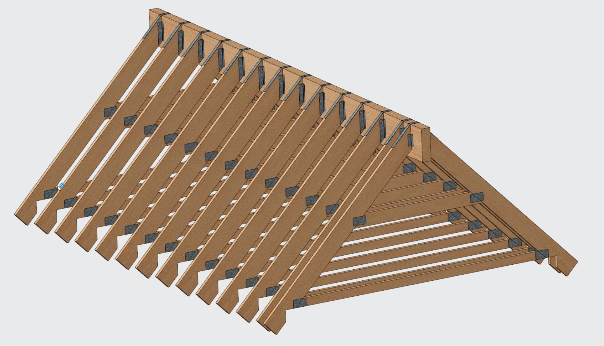

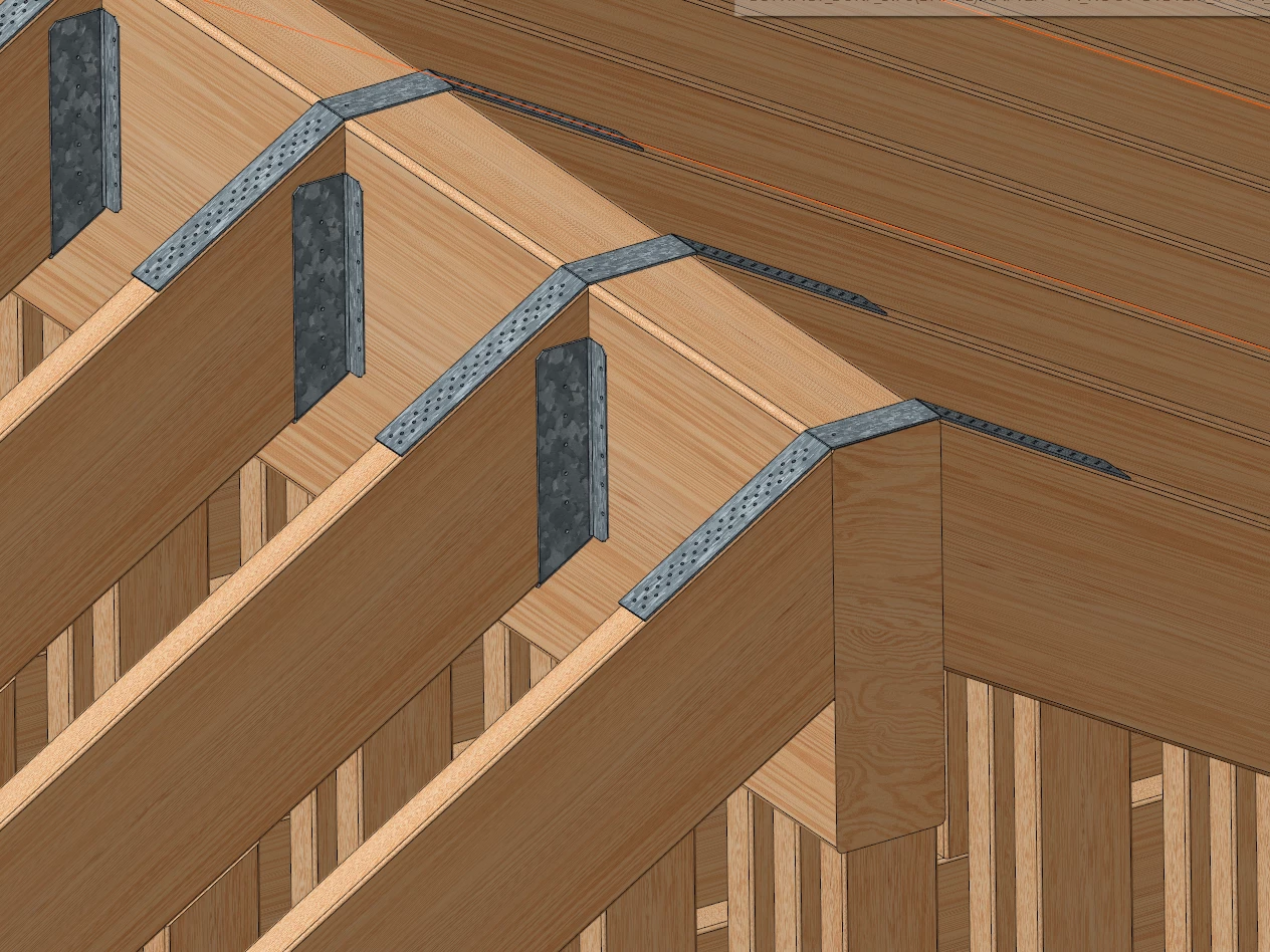

I used AFX to design this roof rafter system and frame including metal roofing straps and joist hangers. You can customize the AFX library as I did for wood framing. You can use it here:
https://github.com/mbourque/afx-wood
This library adds a comprehensive set of standard wood framing components to Creo AFX, including:
  • Dimensional lumber (studs, posts, beams) in all standard sizes
  • Engineered components (LVLs, I-joists, laminated beams)
  • Trim, mouldings, and finish-grade lumber
  • Foundation elements (sills, columns, footings, cinder blocks)
  • Roofing, stair parts, and decorative elements
  • Pre-built skeleton models for rapid top-down assembly
  • Fence posts, rails, and pickets
  • Built-in simplified representation for details
All components are fully parametric and configurable, supporting efficient design changes and robust model updates. The library supports advanced modeling workflows, such as top-down skeleton-driven assemblies, copy geometry propagation, and parametric patterning (e.g., studs at 16" on center).
I used AFX to design this roof rafter including roofing straps and joist hangers.

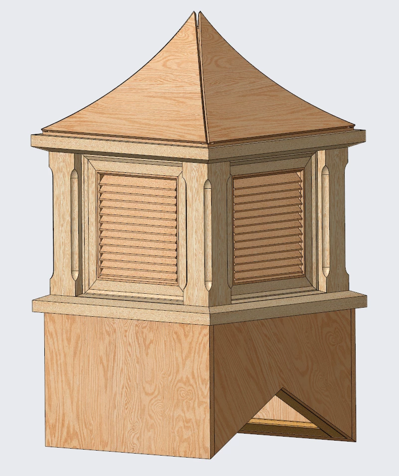

Michael_Bourque
Aug 20, 2026 11:15 AM UTC

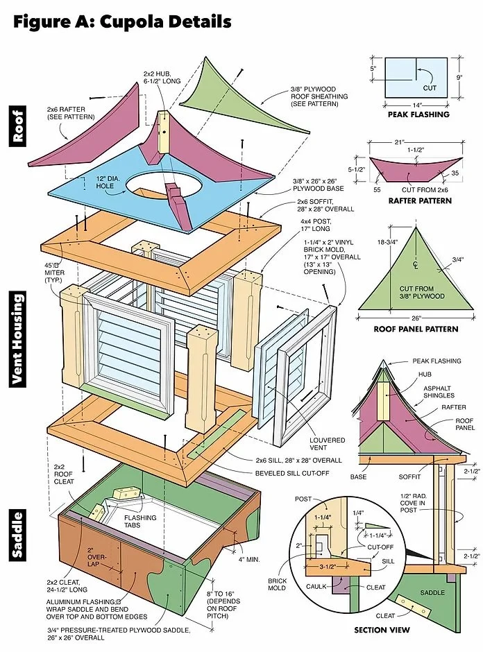

I designed this Cupola using AFX and my AFX Wood Library
Done in Creo 13 with Inseparable Assembly. Download model below.
Michael Bourque
