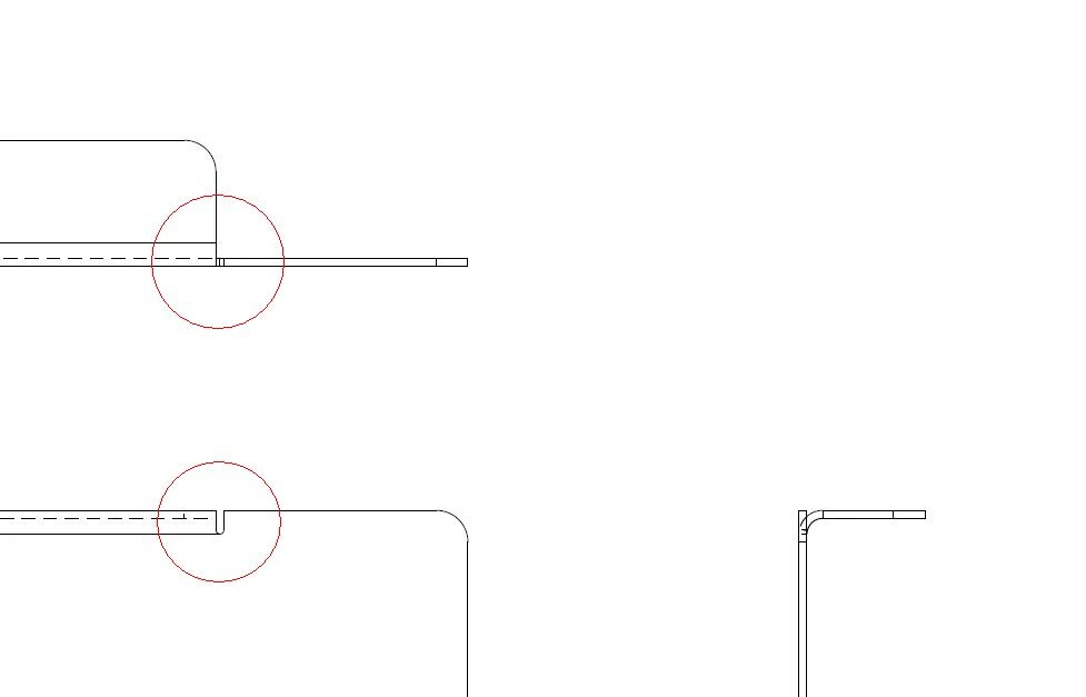

I am using Creo Parametric 1.0, datecode M040. The following PDF drawing is third-angle projection with the view display set to "Hidden." I have circled the areas where the hidden line is stopping before the edge of the part. I have also erased the hidden lines and re-drawn using a sketched line that matches the style to "Hidden" and the hidden line still stops before the edge of the part. Is there any way I can fix this issue?

Rarely does anyone have the keen eye to "properly" show hidden line characteristics. It is nice to see someone who cares.
This might be a hardware font issue or a PDF converter issue.
I can only point you to the config.pro option "use_software_linefonts yes" to see if this helps.

Using the PDF converter within Creo 1.0 with the config option "use_software_linefonts" set to "yes," I ended with the exact result from my earlier screenshot. I would already assume that it is a PDF converter issue. However, using print from Creo 1.0 then using a third-party PDF driver, the hidden line did not break.
August 24, 2012
Sounds like the PDF converter is ignoring the setting. Have you requested information from Support?
