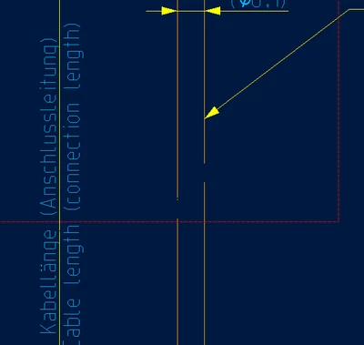

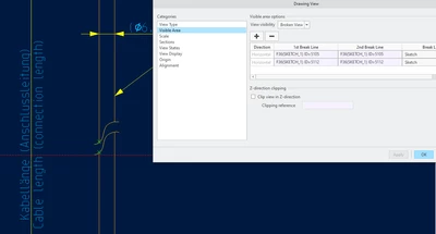

Hi guys,
i have a problém with broken view. When i make in Visible area Tab everything is OK, I can see the break lines but when I click apply and ok and the small window disappears then the break lines disappear too … can’t understand
Thanks for help !

I forgot to mention that the part is made with Cabling mode and I’m using creo parametric 7

Attach an screenshot of the issue along with a screen shot of the view properties window of the broken view selection.

The properties:
View After click OK

Well, that seems random.
Have you tried re-creating the break from scratch? or tried using something other than the sketch break? To see if it's a glitch in that specific break.
Just for testing, make a new view and create a new break on the at view, just a straight break line. To see if it is a glitch in that specific view.
Other tests would be make a test drawing, add the cable to that drawing, add view with break. To see if it is a glitch in the original drawing.
Last one would be to make a new test cable model.
All silliness but if it's a glitch in one specific thing, maybe you can work around it.
