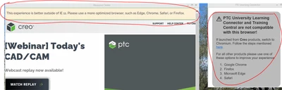

Creo 4 / windows Edge
"This experience is better outside of IE 11. Please use a more optimized browser, such as Edge, Chrome, Safari, or Firefox".
Any help would be appreciated.

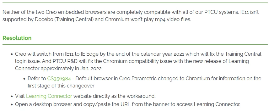

Neither one is compatible with the learning connector.
February 16, 2022
Article - "Unable to connect to LearningConnector starting from Creo Parametric 7.0.0.0": https://www.ptc.com/en/support/article/cs346017
