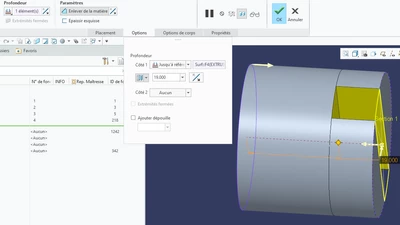

I'm working on Creo Parametric 8.0.4.0, I created a Extrude function with option until reference.

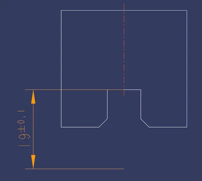

As you can see below, the dimension is reverse.
This problem does not occur 100% of the time, for example if I delete and redo the function, the problem is fixed. Is there a faster way to solve it then recreating the function ?

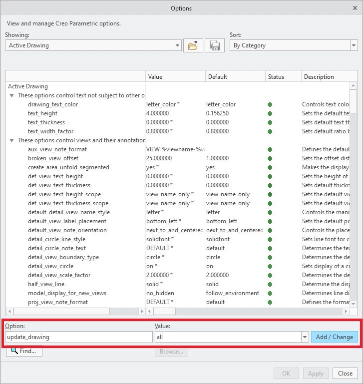

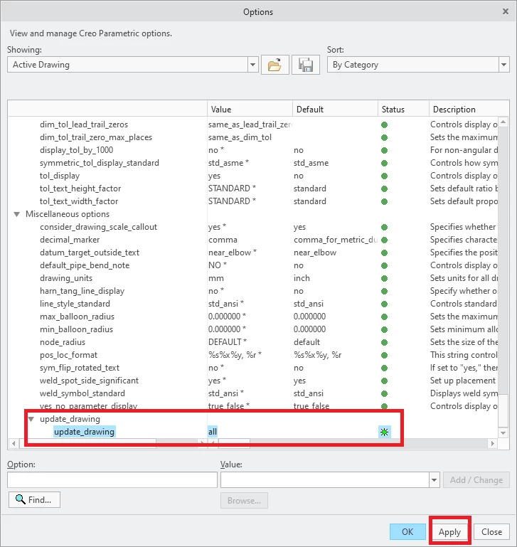

I am not able to reproduce your problem in new drawing. It looks like your drawing is corrupted somehow. Please contact PTC Support.
If I apply hidden option update_drawing all in your drawing and update it, the dimension is displayed correctly.
