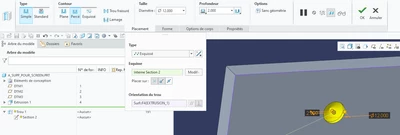

I'm working on Creo Parametric 8.0.4.0, it seems like you can't bring angular dimensions used in a sketch of a sketched hole created in a .prt.
For exemple below, we have a simple sketched hole :
Sketch used (with an angular dimension) :
In the drawing, only the linear dimension appears.
One exception, where the angular dimension pops up in .drw is for sketched hole type : "Simple" and profile "Flat".
Is this a known problem ? Is there any solution ?
Thanks in advance.

You can use a sketch with geometry points to locate the holes and thus use any dimensioning scheme you want, and also use that to pattern the holes using a point pattern.

Thanks, we could use another fonction, it adds more steps nevertheless.
