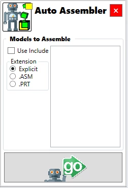

August 4, 2021
I don't know if this is something our Creo guys came up with or if this is a standard Creoson tool but we use something called Auto Assembler. It's exactly what you're talking about.
