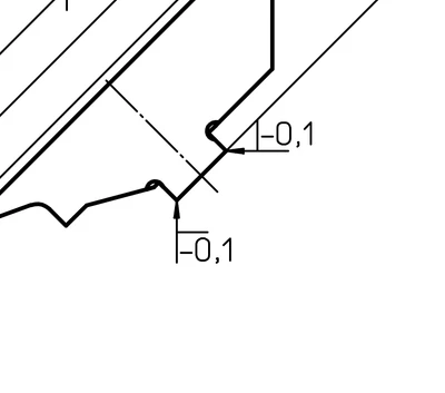

I have these 20+ year old drawings that currently is being re-drawn from newly made 3D-models. In the  old ones it's been annotated like this:
A more common (modern?) way seems to be using a "corner" symbol followed by the tolerance. The symbol is quite similar to the straight angle symbol found in Unicode:

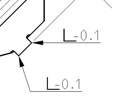

The technical fonts in Creo (font, isofont, iso30985font etc) doesn't include this symbol, so it can't be included in the annotation. My current solution is adding a separate textframe containing only this symbol, putting it in front of the tolerance:
It "works", but I hope there is a better way?

Oct 11, 2022 7:21 AM UTC
I tried this using the instructions here:
https://www.youtube.com/watch?v=TZLOIb-dUp8
It works reasonably, but it's hard to get the rotation and text-alignment to work in a flexible way. As you can see in the image below, where I have rotated the symbol 270 degrees, the text (an editable note within the symbol) doesn't position itself very well (I have tried various combination of settings for rotation behavior and this seems to be the best). I will probably also need to create a mirrored version where the text is right-aligned.

Oct 11, 2022 12:56 PM UTC
You can create all of the versions you need, various orientations, in one symbol using the group feature.  You just need to pick the correct group options when placing the symbol.  Here is one with lot of options defined.
