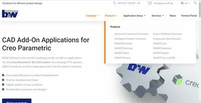

I guess that when you start Creo then its start directory is my documents directory. Because of this my documents directory contains buw sub-directory.
Feb 21, 2023 5:24 PM UTC
There is a German software company called B&W that provides add-on applications for PTC.
CAD applications for Creo Parametric (buw-soft.de)
AFX and IFX are applications of theirs that PTC incorporates.  The company I work for uses their SmartAssembly application to automate certain repetitive tasks.  The folder is BUW because you cannot use an & in the name.  As to what those folders are used for, I do not know.
Feb 21, 2023 7:42 PM UTC
I thought SmartAssembly is made by Sigmaxim not B&W?
But it is confusing as Sigmaxim also has SmartHoleChart, eg. on their website, which I was pretty sure is a B&W product...
TomU
Feb 21, 2023 8:28 PM UTC
It's complicated.  As I understand it, B&W are the developers for Sigmaxim's products, and Sigmaxim is the reseller for B&W's products in the USA.
