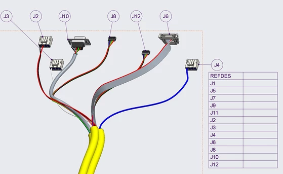

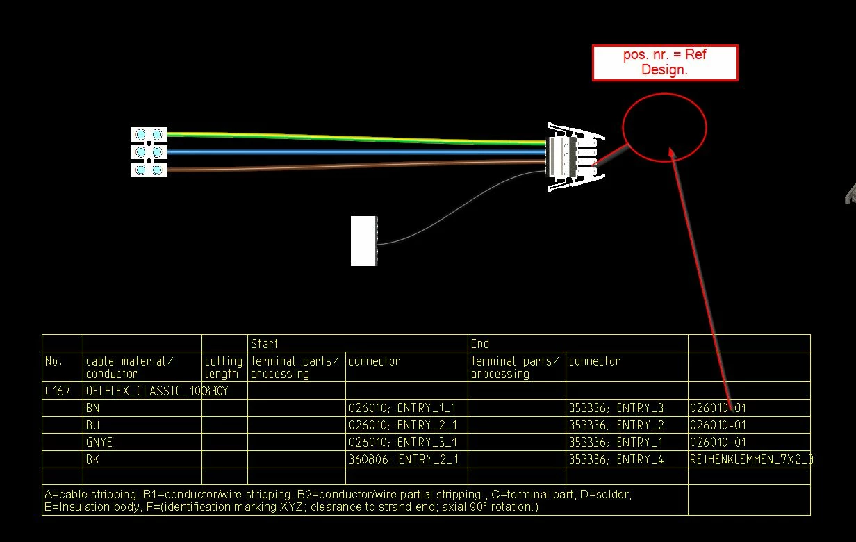

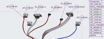

I would like to know, if is somehow possible to use the Referenc Designator from harness as parameter for balloon, so I can make the position balloons in my drawing.
Way the Ref. Designator: because my harness has more than once the same connector. I have to specified this.
The Way to do this is the Ref Desinator
But positioning is assembly functionality.
So how can I ether make handmade note as position with REAL harness parameter using the harness model as active (.prt) ot to make positioning using the parameter of the harness and to have the ".assy" as model..
Explanation: I have assy ot the cabling: harness and connectors and I have just the harness model in the drawing inside.
Tank you!
At least one way to show the connector refdes values for the connectors in the drawing is to (I'm using creo9)...

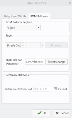

  • Create table for the assembly and open "properties" dialog for the table.
  • Set the "BOM Balloon parameter" to "asm.mbr.connprm.name"
  • Create balloons for the assembly and it shows the refdes values for each connector.

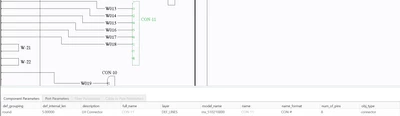

Unfortunately, my problem starts at Schamatics. There is a system parameter "full_name".
This parameter has the behavioral to be the reference designator. This means that if I place more than oncs the same component, the fill_name count this:
example_ Identify numbe and suffix 01...02...03 an so on.
That is way, I think, this is my reference designator.
But unfortunately, the parameter "full_name" will be not exported in the XML file.

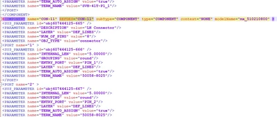

But isn't the "full_name" parameter from the schematic always exported as REFDES to the xml-file?
As here
Creo Schematic CON-11 highlighted... Full_name = CON-11
Exported xml shows the REFDES as CON-11

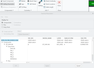

Then you can check from the cabling parameter in creo to verify that the parameter has been correctly read for the connector (here shown the "full_name" J2 from previous post)
Or do you just want to display the component name in each balloon (in my case the name does not fit inside the balloon)?
