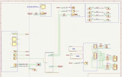

a) The schematic input. Meaning the logical connection and cable + connector selection (file that is read into the Cabling module).

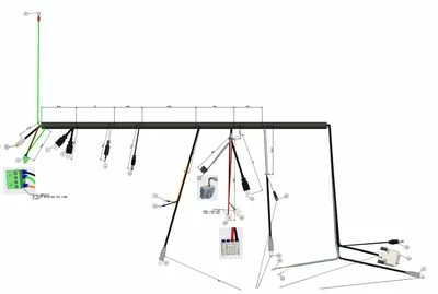

b) The flat diagram output + BOM for the manufacturer to make the harness for us. The flat diagram below is actually created from the schematic above (the top level schematic only shown).

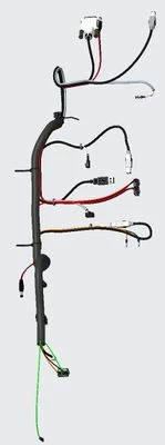

So the intermediate part (routing)
is just to check that everything fits and to get the lengths for the cables and wires. It could be done by sweeps, curves, lines or what ever but the current way of creating route networks seems to work well for us also. But I believe the Cabling module is currently the only way in Creo to get us from a to b...

So Creo can generate schematic from 3D cabling? I didn't know that.
Also I am not happy with the way it flattened the cable, but may be that is the right way what it is and technically correct.
