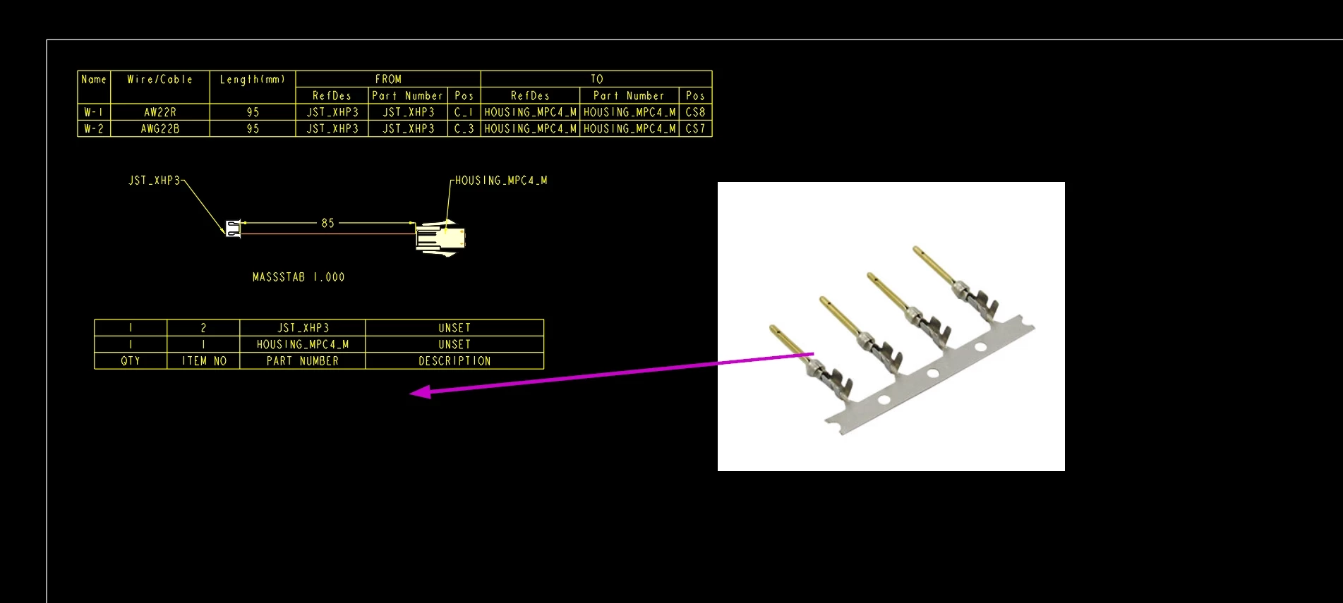

I have the problem to understand how can I do a rooting and manufacture drawing of the wiring with:
2x housing, 2 wires, 4 crimp contacts.

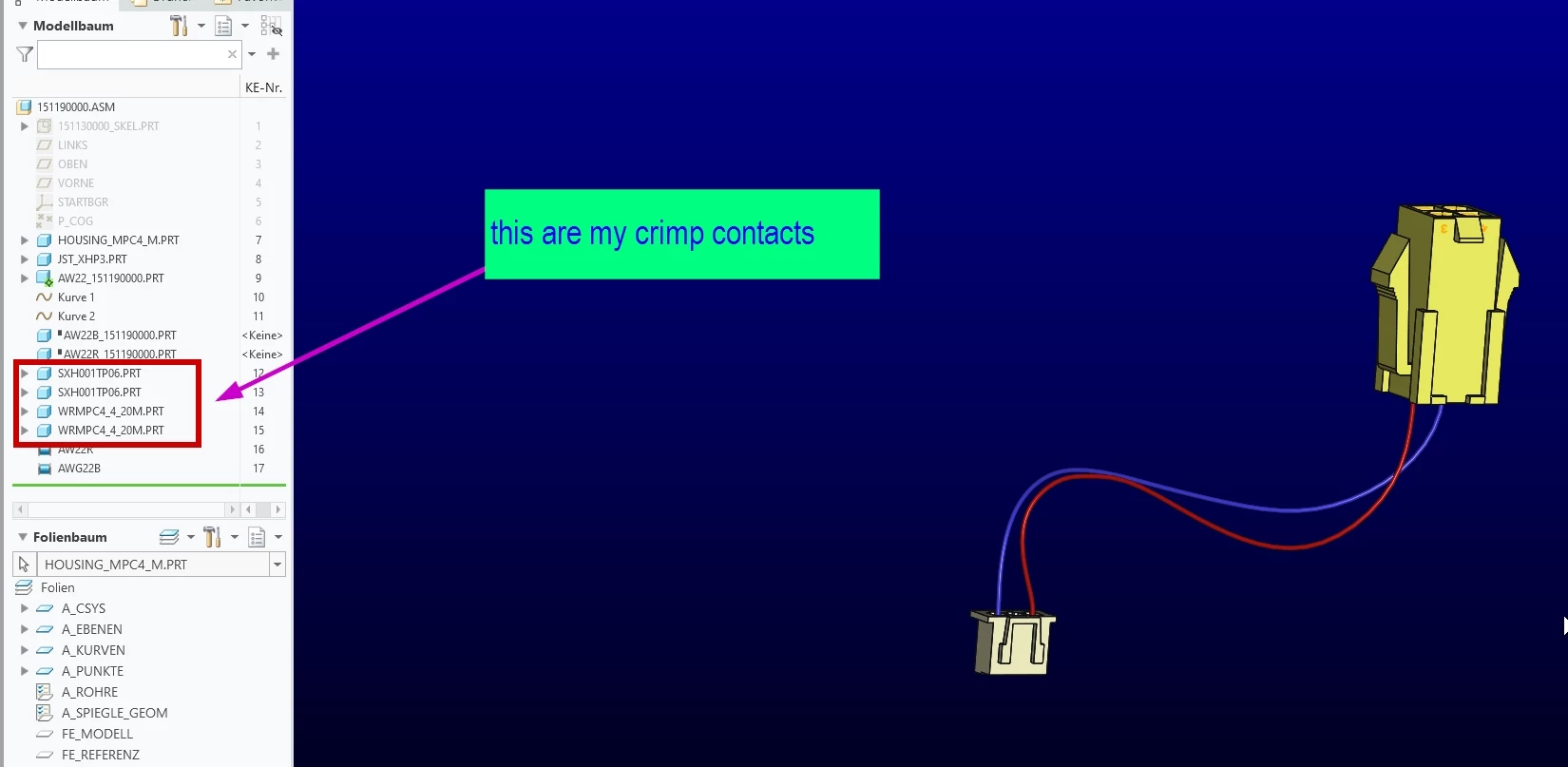

Even I do the rooting, I use the C-Sys of the housing parts. All is going well, but afterword's in the manufacture drawing I have the correct table with the 2 wires, and another table with the 2 housings. This is OK. But I wish to have also the 4 crimp contacts.
How can I put this parts in?
The crimp contacts can be done with 100% geometry, but better is if these should be just a empty parts.
Are there some ideas for this?

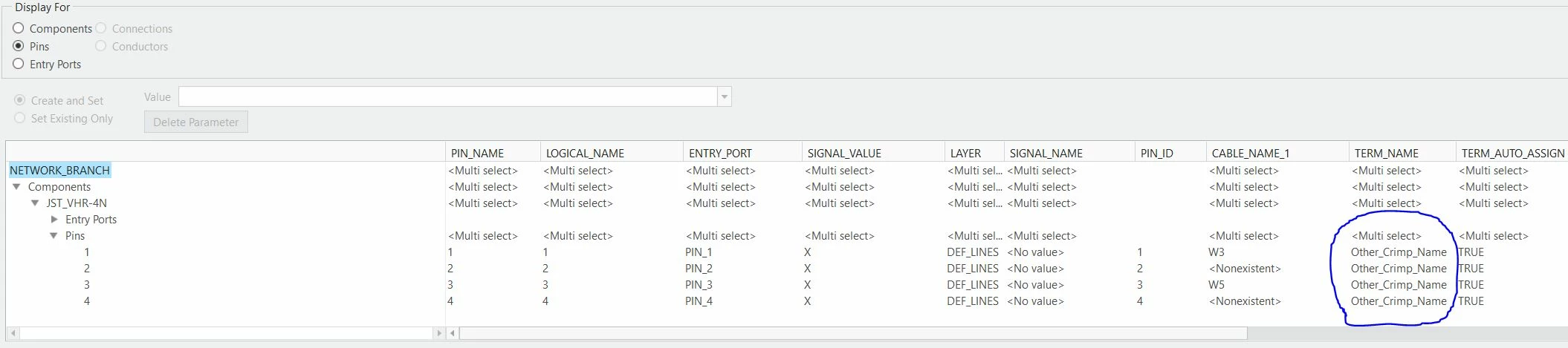

We add the crimp contacts into the drawing tables by adding the "TERM_NAME" parameter for each connector (see attached terminator_added_to_cbln_prms.JPG). In this example I edited the TERM_NAME for two connectors. New crimp names are Other_crimp_name and Some_crimp_name.

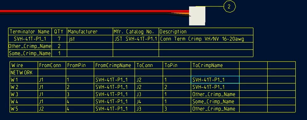

After this we use the following report parameters on our drawing tables (terminator_tables_in_drawing.JPG)
&harn.term.name
&harn.run.cond.from.term.name
&harn.run.cond.to.term.name

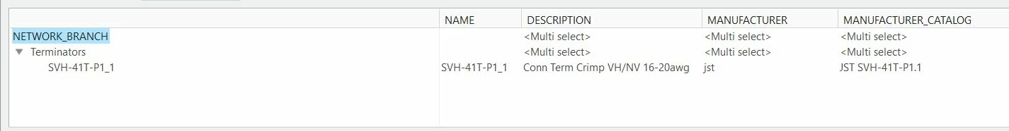

You can add extra info to the terminator via the "Logical Data -> Terminators -> Edit" (Description, Manufacturer). For the crimp quantities table we use parameters...
&harn.term.name
&harn.term.qty
&harn.term.MANUFACTURER
&harn.term.MANUFACTURER_CATALOG
&harn.term.DESCRIPTION
Currently we do not use any empty parts for the crimps on our model tree since our subcontractor uses only the drawing information to create the harnesses.
