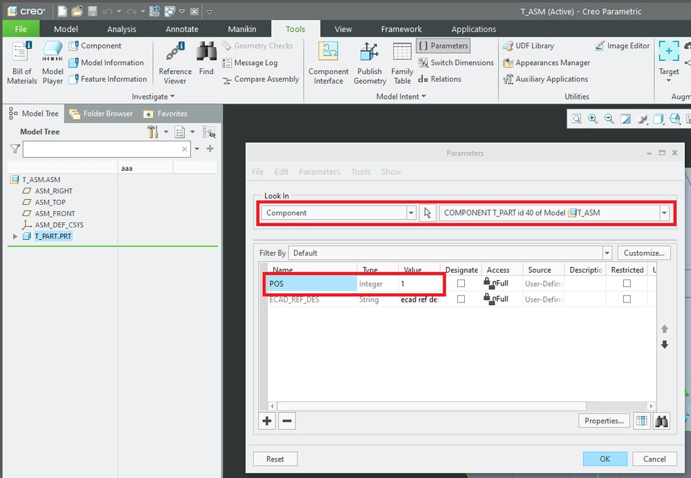

  • open Parameters dialog box ... see following picture
  • you can define Total_Qty parameter just as the POS parameter is defined
  • close Parameters dialog box

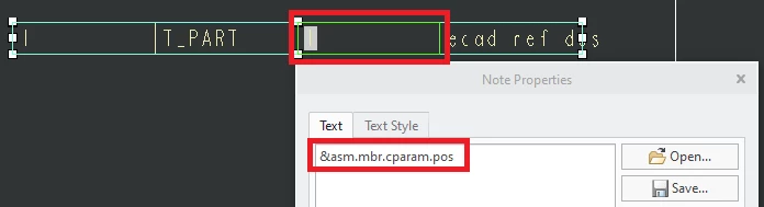

  • edit contents of 3rd cell ... see following picture
  • you can enter &asm.mbr.cparam.Total_Qty to display value of Total_Qty parameter

according to https://support.ptc.com/help/creo/creo_pma/r10.0/usascii/index.html#page/detail/System_Parameters_for_Drawings.html
&asm.mbr.MODELPAR displays parameter defined on part/subassembly level
&asm.mbr.cparam.COMPPAR displays parameter defined on assembly component level
