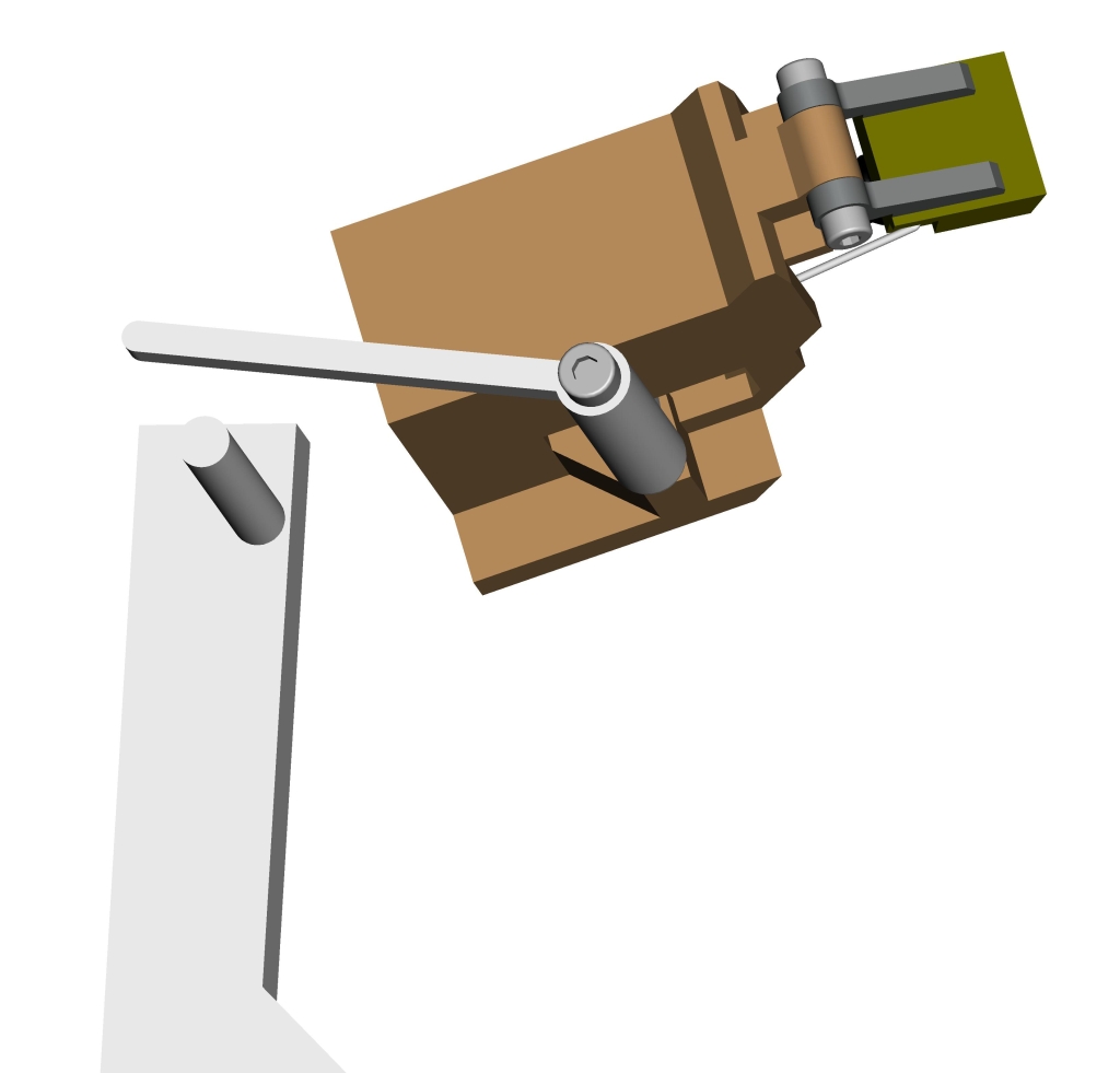

I am working in WF3.
I am modelling a Swedish Navy Sailship from about 1650 and have now come to the guns of the lower decks – the ports should open and the barrells poke out through the openings.
I have modelled a gun-unit which works fine and I am now trying to make a drive-rail running along the line of guns to do the required movement of all ports simultaneously.
The drive rail moves in a straight line (up and down in the picture below) and should push the lever on the gun-unit to its open position. The return movement of the gun-unit lever will be by means of a spring as the drive rail moves downwards again.
The gun-unit lever move approximately 90°.
I have connected the drive-rail with a gun-unit lever using a slot connection and it works fine.
My problem is that the drive rail has to move a certain distance to move the gun-unit with the largest turning angle and therefore a slot connection is not good enough.
I have tried to use a cam-follower connection using the surface of the little pin on the drive-rail as one part and the surface of side of the gun-unit lever as the other, hoping that a cam-connection with a lift-off property would do the job but Proe will not accept this.
Am I trying to do the impossible? Is such a cam-follower connection not possible?
If somebody wants to have a go at it I would be happy to upload a zip file (16 Mb)
Grateful for any help

Silly mistake!
Defined the flat cam-surface front and back points incorrectly.
Redefined them and the thing works!

Hello Tom,
attached are 2 videos, one showing a single gun_unit and one showing the whole broadside.
My current problem id that while all gun ports open to the same angle, their respective closed position vary as much as 20°.
The current model has cam-follower without the lift-off feature which means that the gun port that has the largest "close" angle prohibits the drive rail to conrinue and close all ports properly.
I do not have the Proe-feature of simulating a rubber-band connection so I cannot simulate the closing movement as desired.
In real life the cam follower would be with lift-off feature and there will be a spring or rubber band pulling the individual gun ports to their correct closed position. Video Link : 7139 Video Link : 7140
August 2, 2016
That is really cool!  Could you change the point of contact on the levers so each one travels a different distance (to match the angle variation)?
