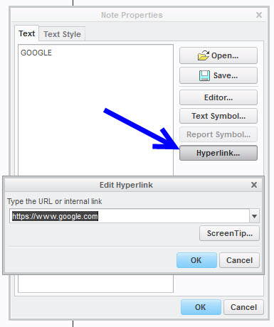

Can a hyperlink be imbedded into a drawing format?

Hello Dan,
You can add a note in the format, and the in the Note Properties window add a hyperlink to the text.  One thing to remember is that the note should be inside of a table cell, so that it can be accessed when the format is applied to the drawing.
Notes outside of a table, in the format file, cannot be edited or selected in the drawing.  If the hyperlinked note is in a table cell, you can access it in the drawing by using the CTRL button and clicking on the link.
