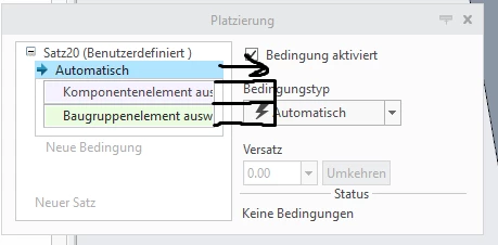

Can I adjust the size of the window for redefining features?

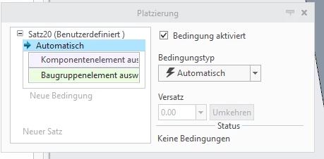

When I edit features and the references for parts in my assembly are gone, I need to redefine the constraints using this window.
This is what the window looks likeThis is what the window looks like
But the names of the features are way longer than the window, so they mostly do not fit inside. Is there maybe any way to extend the window where the name of the features is written into?

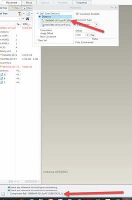

I usually move my mouse over the reference and look at the message log to determine the feature name. Its a horrible work-around but the only one I have

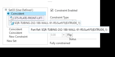

In Creo 8, if you hover over the constraint it will automatically expand so you can read the full name of the feature so it appears this has been addressed.

While your mouse is hovored above the window, you can actually scroll using your mouse wheel, so that the name of the feature moves left and right within the window. That way, you can read the name of the feature. (I'm using Creo 4.0)
