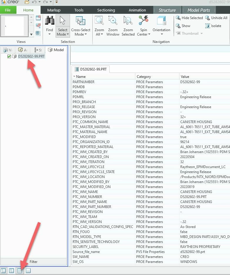

Can I export a Creo View file with its file history (showing user and last saved date)?
I would like to see some info from the TOOLS / INVESTIGATE / FILE HISTORY in a pvz file.  that way non-creo users can find out who to ask a question to if they want more information.   Is it currently possible?

In Creo View, select the model and then Toggle Lower Data Panel to see all the models attributes, Creo and Windchill.

So...  we are not using Windchill (I know.. I know...)  we are using Teamcenter.   So i would like to know how to get the info from that FILE HISTORY function from within Creo.  It seems it doesn't export that information.  Just all the other parameters.
