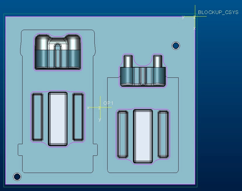

Hi again,
Im wondering how, if possible, I can hide or display certain features in different views of the same drawing. For example, in the image I uploaded, I have two coordinate systems, and I want to display only the Blockup csys in Top view 1 and only the OP1 csys in Bottom view 2. This image it doesnt actually matter so much, but when I have some jobs with three or four co-ordinate systems all overlapping or nearby to each other it can get real confusing.
August 21, 2014
Nick,
yes, you can, but it is little bit complicated.
1.] set the following detail configuration options in your drawing
draw_layer_overrides_model yes
ignore_model_layer_status yes
2.] in the model create layer for every single CSYS
3.] in the drawing ... REPEAT the procedure for every view
  • in left pane switch model tree to layer tree
  • at the top of the layer tree there is a combox box, expand it and select the appropriate view
  • hide layers containing unwanted CSYS
  • save layer status

August 21, 2014
In general, these items are managed by layers. You can specify layer status unique to every view.

August 21, 2014
Martin, I am not sure #1 is required. I don't remember setting this for anything and I manage layers per view directly.
Of course, combined states can also be used.
August 21, 2014
Antonius, What do you mean by combined states? I've seen the dialog box popup when i enter a drawing asking what combined states I wanted, but I thought that was just fro exploding assemblies and such?
