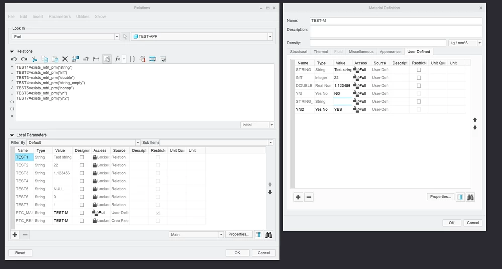

I created a simple application. It adds a custom function to relations: exists_mtrl_prm(). It takes an argument—the name of the parameter to be checked in the current material. It returns either its value, if it exists, or NULL, if the parameter doesn't exist. Any type is converted to a string.

Voronov12-AmethystAnswer
Nov 27, 2025 8:09 PM UTC
