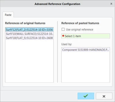

in assembly mode, when using copy + paste special + advanced reference configuration to repeat the assembly of a component or group of components, the "Use original reference" checkbox is not checked and the reference collector is empty:
Has this behaviour changed at some point?  maybe I'm misremembering, but I swear before I didn't have to process the list of references (3 above, not a big deal, but gets quite tedious to keep checking on that box when that list is larger)

Hello @pausob
I checked Pro/ENGINEER Wildfire 3.0 M250 (was releaed in July 201, 12 years ago) versus Creo Parametric 4.0 M150 (your version), and I do not see any difference of behavior (ISO functionality - No Regression). Behavior per default (recorded in the 2 attached movies in sessions started WITHOUT config.pro) is as follows:
  • Use Original Reference unchecked
  • But collector proposes per default what was the original reference used for the assembly constriant of originally copied component (allowing simple "Ok", without needing to "reselect" the wished reference)
Now, I can see that this collector seems to be empty per default in your snapshot. Related to that, is this reproducible in all assemblies when using this "Paste special" capability?
  • If answer is "yes", my suggestion is to restart a new session without any config.pro (ideally without any toolkit as well):
    • If still reproducible like this, please open a case to us as suggested by @MartinHanak (no further ideas if so, sorry ...)
    • If not reproducible in standard, isolate option by dichotomy (if approach not clear, I can share an article later). Axis of investigation to isolate this option: one option containing scope in it (like default_scope_comp_setting option ?), preventing maybe usage of external references (on components, or skeletons, or assemblies, etc ...)
  • if answer is "no" (means reproducible only for some assemblies, but not others), and persists EVEN without usage of any config.pro file, please also open a case to us and share data, in order to investigate what happens in the given impacted specific context.
Hope this helps at least for the next step of your investigations.

Yes, tried it on another assembly, it works as in your video;  the original reference is in the collector, and the checkbox "use original reference" is unchecked...
Now that I think more about it, the check-box was never "on".  I also vaguely recall that my workflow stalled sometimes by the reference collector being empty, but didn't give it much thought before.  So sometimes it works, sometimes it doesn't.  I wonder if it's just for me?  I don't have time to investigate.
Also, I suggest that this checkbox is rather confusing - for it is not a "setting" that persists.  It functions more like a push-button that, when pressed, populates the collector with the original reference.  I think Creo is full of such GUI oddities.
@sacquarone , I don't have the means to submit a case to PTC, but I'm hoping you relay these concerns to the software development team.
And to be clear, there is no config.pro setting to control the state of the "use original reference" (so-called) checkbox ?
