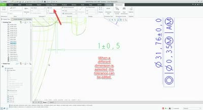

See pictures above. I am having trouble editing the tolerance on a drawing. Only the one that I want to change isn't working of course. I think it might have something to do with it being a draft dimension. Thanks in advance!
Best answer by KB_9103270
I switched General to None and that allowed me to change it. Thanks!

Check the dimension text box and see if the tolerance was manually added.
March 11, 2022
Dale_Rosema
March 11, 2022
Try to switch from General to Symmetrical.
