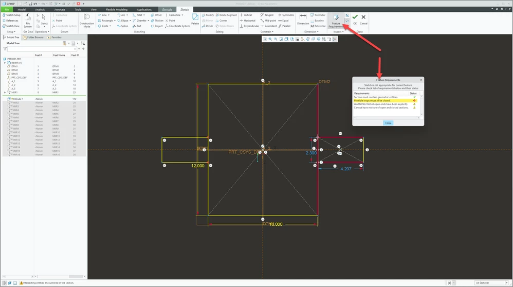

I suspect this is the issue that you are having. Activate the feature requirements and a window will indicate the problems with your sketch.
Jul 11, 2024 6:54 PM UTC
I have two issues under Feature Requirements:.
     A yellow triangle: "intersecting entities encountered in the section"
     A red circle which just has "Basic Requirements".
"Basic Requirements" is not a very helpful error message.

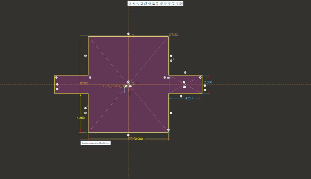

Jul 11, 2024 6:50 PM UTC
The sketch will be filled as seen below when it is "valid".
