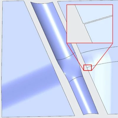

I have a fairly simple parting faces quilt that I need to finish out but I can't get the boundary seam of the opposing cylinders to become tangent.  After completing the parting faces quilt I need to use the thicken option to uniformly thicken these faces to build a gutter model; as is I can only thicken the quilt to about .125 where it will need to be .500 in thickness.
Shown below is the area I am struggling with.  The highlighted edges show the area that I am working on.  I have penciled the non-tangent seams in red.
I have attempted different options from Boundary Blend to the Style function.  I have attempted this with and without curve rails in the red highlighted areas.   I know that there naturally is an area of twist due to the conflicting up facing and down facing cylinder extrudes.  Might there be some kind of option that would iron out the natural seams to allow tangency throughout?
(I also tried this as a simple 4 sided boundary blend but the tangency toggle failed on the left side which has 3 edges)

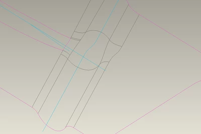

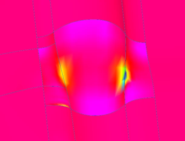

Can you display curvature of the curves/edges that are highlighted in red, particularly the left side?  Are those three edge tangent and curvature continuous to begin with?  Any chance you could share a stripped down model (even a .stp or .igs)?
pimm15-MoonstoneAuthor
Sep 17, 2025 5:12 PM UTC
The curvature plot does show the areas of concern.
With the above example I did not build this with any style curves but the surface set on the left of the cylinder transition was made by boundary blend and the surface on the right of the cylinder transition was made by style surface.
I believe that I have attached a STEP model of the above quilt.

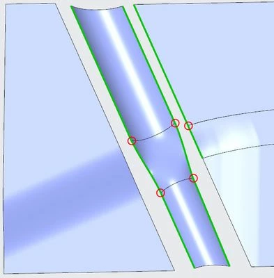

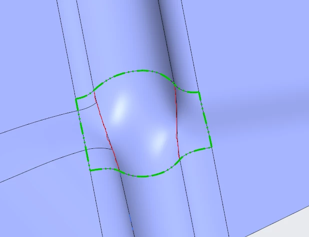

The green edges are not tangent at the highlighted points
And there is a 9µm gap at the point
You should fix these issues
Then surfaces with tangent joints can be created.

I do believe that the error of tangencies must be from my construction technique.  At 1st consideration I thought everything should have tangency because each of the faces inside of the rectangular highlighted region (shown on my initial post) was created using tangency.  1) I built a boundary blend between the 2 opposing semi-circles using tangency on the 2 edges. 2&3) I built the side faces in the rectangular region by using tangency on all of the edges.   What I didn't see initially and see now is that the edge joints that you have circled did not have a tangency curvature that follows the straight through edge continuation.  I would likely not have that issue if I used a Style curve network which would take that straight through lined up with the beginning and ending edge with true tangency.
Even though I would like to solve my submitted problem I am seeing that this likely is an exercise in futility.  Even if I could get a nice tangency fed through every face within the rectangular region it would have to suffer at the transition zone where the upward curved faces meet the downward curved faces.  Moreover, because of that I will not be able to use the Thicken function to get the needed .50 thickness.
If there was a way to minimize the transition distortion that would be great, but I do think that it is time for me to punt with my original concept. ☹️  Sometimes the issues of doing something a certain way is not apparent until after fully going down the rabbit trail.   If someone can prove that this is possible that would be awesome, but I won't hold out any hope that this is possible.

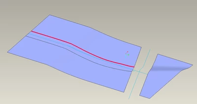

Using the STEP data, I am able to create tangent connections across the inflection of the "cylinders". There are issues with the geometry in the STEP file in the context of what you need for the design. The best option would be to create the geometry incrementally while checking the ability to offset it to the needed thickness.
It appears that the inflection of the cylinders is not the issue but the topology of "base" surface. This may or may not be true for the native Creo source geometry.
In this image tangent edges are displayed as dimmed, so all of the grey edges are G1 or higher continuity connections to adjacent surfaces.
Based on the STEP geometry this boundary (in red) is particularly problematic (the quilts do not intersect/touch).
