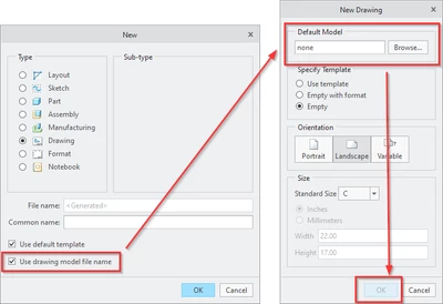

can't make drw file
I am using Creo Parametric - Release 6.0 (connected) 6.0 6.0.6.0
Can't make drw file at some part, ok button 'color is grey
Here are the errors that I faced

    November 8, 2021
    Your post is missing a screenshot of this error.
    November 8, 2021
    Like @VladimirN said, you haven't attached any screenshot, but if I had to guess, I'd say that you might have activated "Use drawing model file name" option when choosing Drawing as a new file but in the second window, where you configure drawing details (like template, format etc.) you haven't defined a default model, so there is nothing to copy drawing file name from, thus preventing you from creating a drawing.
    JOHNAHN7-BedrockAuthorAnswer
    7-Bedrock
    November 8, 2021
    Hello
    This is s.o.ahn, post above issue.
    Thanks for your replay.
    Your guessing is correct
    I had found the solution, that is same file name  being in some fold.
    One more time thanks for your replay.
    Best your regards
    s.o.ahn
    November 8, 2021
    Glad you were able to sort it out 🙂
