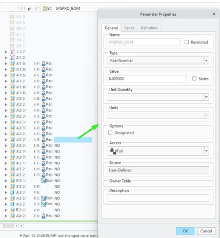

I'm using Creo 8.0.10.0. I am trying to create a mapkey that will create/set a yes/no feature parameter ("Feat Param") from the model tree in an assembly. However, I need to be able to tell Creo which feature (part or subassembly) in the model tree is to have the parameter applied to, but when I click on the parameter field in the model tree, the parameter window opens and the mapkey window then becomes inactive and I cannot pause/resume or do anything until the parameter window is closed. Is there any other way to set these parameters that would maybe allow the mapkey to be recorded?

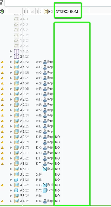

This is a feature parameter and not a part parameter. I don't have a good understanding of the differences but I thought you couldn't see the feature parameter when you open the model because it's made at the assembly level? The same part can end up with different parameter values if it is in multiple different assemblies. Once you add the feat param to the model tree as a column, all you do to set the parameter for a certain part/sub-assembly is to click on the cell in the model tree and the parameter properties window opens up. In the example below, I would like to create a mapkey that will set a selected component's "SYSPRO_BOM" feat param to a value of "NO". I don't mind if I have to start the mapkey, then a pause to select the column cell, then resume the mapkey. Or if there is any other work around method...
Thanks!
