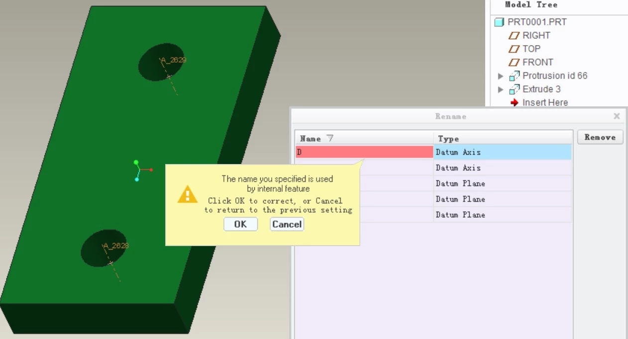

In attached model, when I rename the two axis A_2628 & A_2629 to D & E, it come up a error: Name already exists. But I can't find the axis D & E in the model, can anybody help?
This model is copied from another model and I deleted some features for the company confidential reason.

In the original model, there have Datum Axis D & E and used for some G&T tolerance, but in the copied model, I can't rename the axis name to D & E, I found the name D & E related to the feature "Extrude 3" because of that if I deleted "Extrude 3" and create another axis then it can be rename to D & E, but I can't find the name D & E in feature "Extrude 3".
When I use File --> Prepare --> Model Properties --> Names, I can't find any name of D & E, if I rename the axis to D & E, it shown "The name you specified is used by internal feature", please see attached picture.

I got the information from my colleague, in the feature of "Extrude 3", the original model have 4 holes, the name D & E are specified to 2 axis of the 4 holes, but in the copied model, he redefinded the feature to deleted the 2 holes, but the name still be occupied by the feature, I don't know if it's a bug of Creo 2.0 or if any method can solve it.

l think it´s a bug. Same thing happen to me quite (Creo 2.0 M120). Doesn´t matter if it´s a name of axis, extrude or sweep.
Try to restart Creo.
Solution: Use a little bit different name. D ---> D_01

Seems D & E are orphan names in part databases. If possible, submit a Tech. Support case with actual data.

This is general issue in PTC creo as well as pro-e, once i faced same problem and i discussed to PTC care they also not able to fix problem but we concluded that once we create any axis by feature like extrude after that if feature is deleted then axis name variable remain in memory so we cannot give that name to any other axis. so best way to resolve, before deleting feature rename that axis random name like zzz1125 so we can use that axis name for any other axis.
