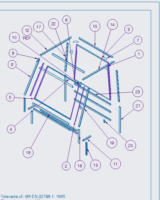

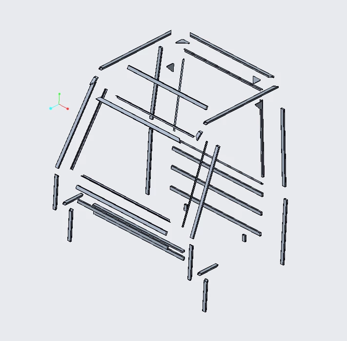

I used AFX and I created an exploded view in View Manager. After some assembly modification, replacing and movement of parts I verified my exploded view in assembly, which is updated, but in drawing the view showed these components overlaped. What should I do to have the exploded view updated in drawing?
Another thing, how I can add a balloon to the 12 component, because Create Balloon by component doesn't work?

Make sure you "save" your explode view modifications in your model.
Make sure you regen the views in your drawing after fixing your position.
Make sure your view orientation in your drawing is the same as you  have in the model (save the view orientation in the model to use it in the drawing)
As far as balloon 12. If there are any other views with balloons, make sure 12 isn't on them. Check the drawing tree to verify balloon 12 isn't hidden.

I use Creo 7, How can I regenerate my view in drawing?
StephenW
For regen, use the review tab in the drawing, Update Drawing view for the one view.
Update sheets for all the sheets.
