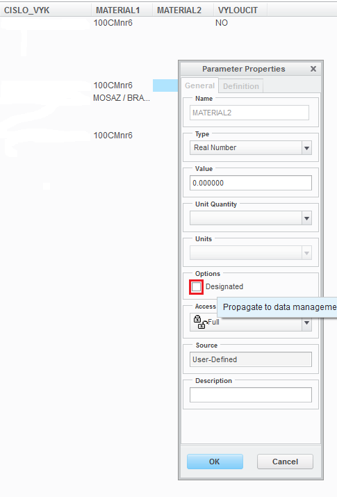

I'm wondering if I can setup the model tree to show if a parameter is designated and allow the setting to be changed there?
We are using component parameters in the assembly for the find number, it would be nice if we could see if it's designated. even nicer if it could be changed there, instead of going to the parameters and using a filter to only show the find number component parameters.
November 11, 2016
Parameter can be designated from the model tree only if it does not exist in the selected model, otherwise the model tree only let's you to edit the value if not locked.
